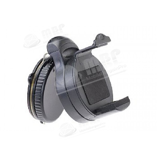

I have the brodit mount like the one in this pic...
Click the image to open in full size.
and one of these...
ADJUSTABLE WINDSCREEN MOUNT HOLDER FOR Sony Ericsson Xperia X8 X10 Pro X10 Mini | eBay
I unscrewed the rear suction part and stuck the front part to the brodit mount... So I can swivel the phone 360 degrees
Ill post some pics of mine tomorrow when it's light..
