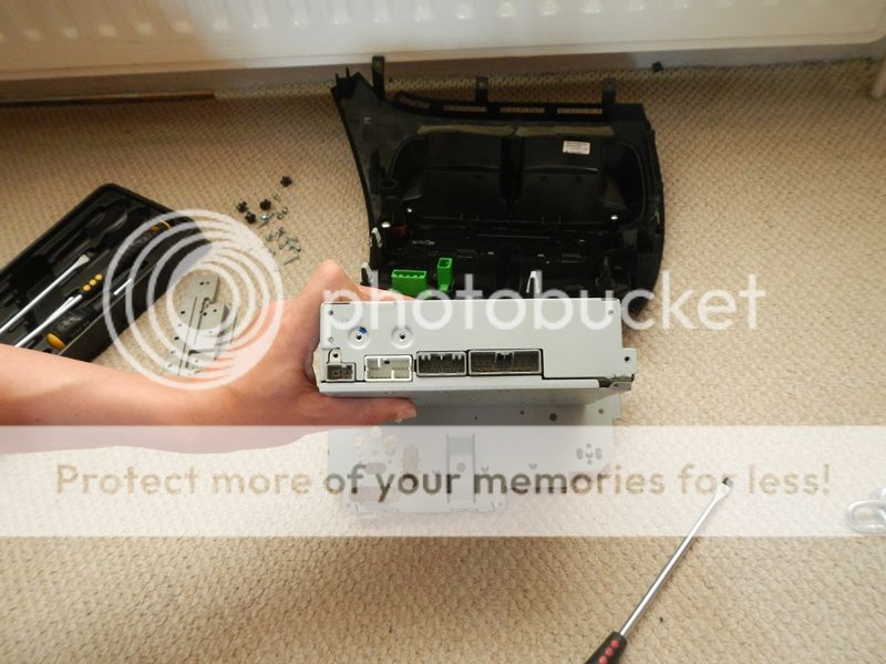

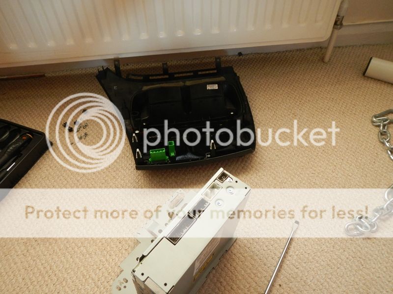

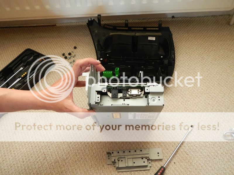

Remove all the screws holding the radio to the front plastic. There are three clips above and below the unit holding it onto the front plastic. Unclip these using a flat head screwdriver.
Like this:

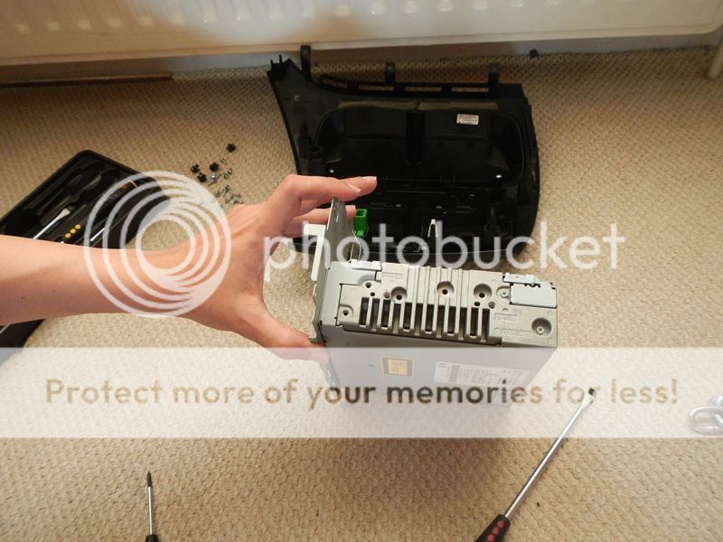

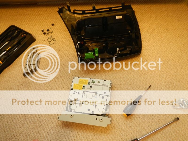

Remove all the screws holding the heatsink and remove the heatsink:
Like this:

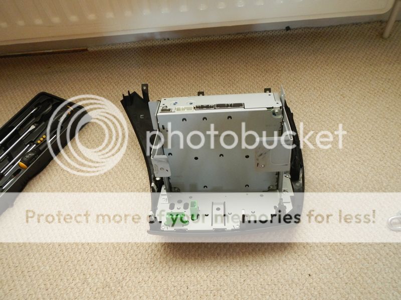

Remove all these screws as well:
And all of these:

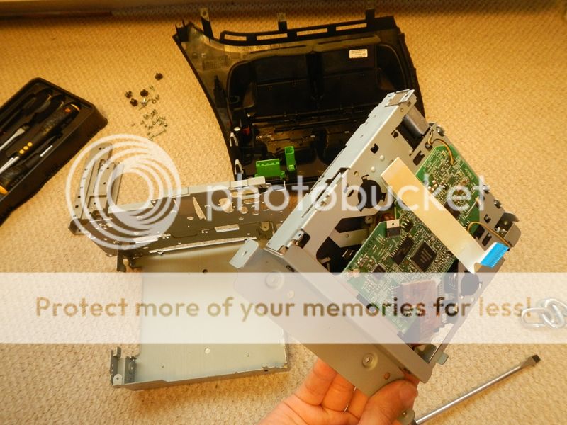

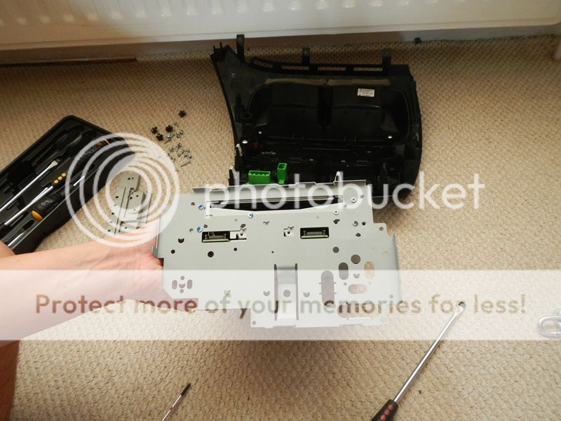

Now remove the bottom screws and cover:

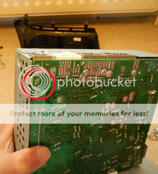

The one tab in the corner needs to be bent as shown to release the circuit board:

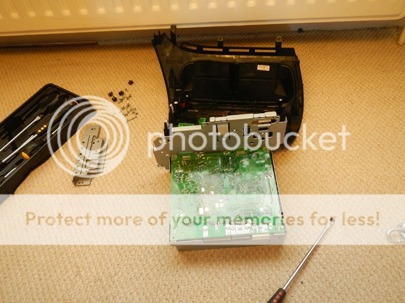

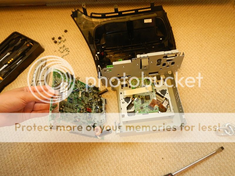

The circuit board should come out like this. Disconnect the CD drive cable as you remove:

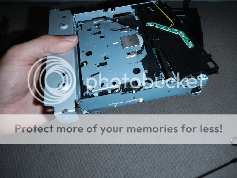

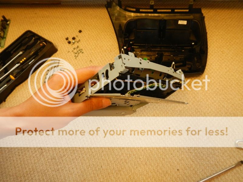

If you have removed all the screws in sight, the CD drive should just come out:
Like so:

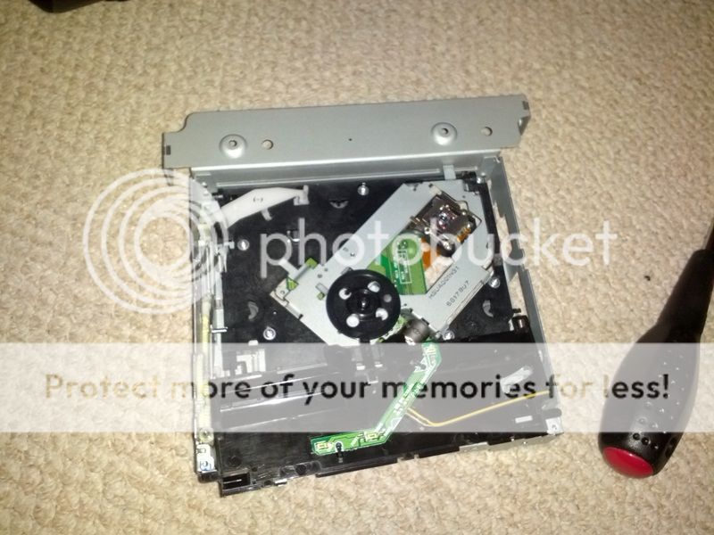

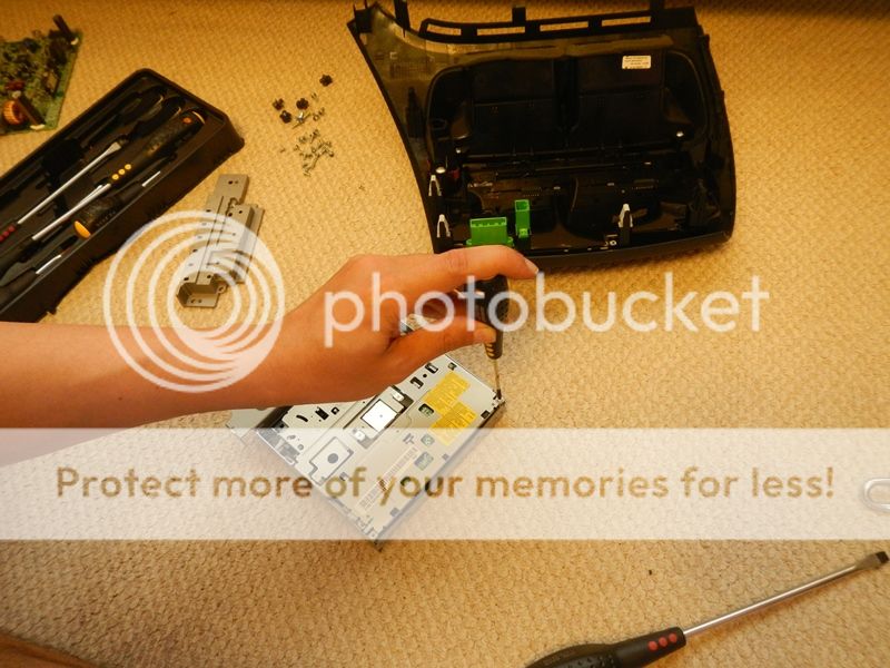

Remove the two tiny screws:
And remove the cover like so:

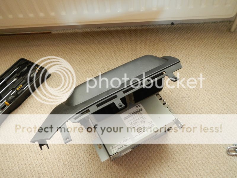

To get the other half off, slide to one side and it should come off its hinges:
Like so:

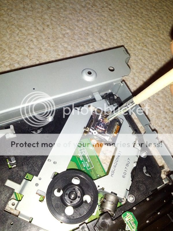

Now clean the lens with a soft brush and some lens cleaning fluid:
Wipe dry with a paper towell if necessary.
