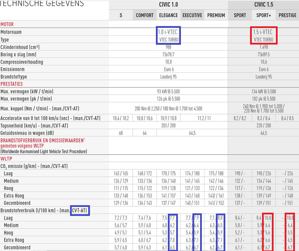

I know, I've seen the WLTP figueres too, I'll even share them with you
Indeed, we're talking about the recent and supposedly more acurate WLTP method, not the NEDC2.0 figures in wich the 1.0L kills the 1.5L.
So its true, the smaller engine has similar or worse consumption.
I know the comparison, I know the difference, but the price difference was too high, for my dad, so we bought the 1.0L instead.
If it was up to me alone to decide, I'd take the 1.5L in a heartbeat.
The dual exhaust, bodykit and keyless system alone are worth it besides the pepier engine.
So yeah if fuel economy is wha you are looking for, you dont have to take the 1.0L over the 1.5L
But that wasn't my question
