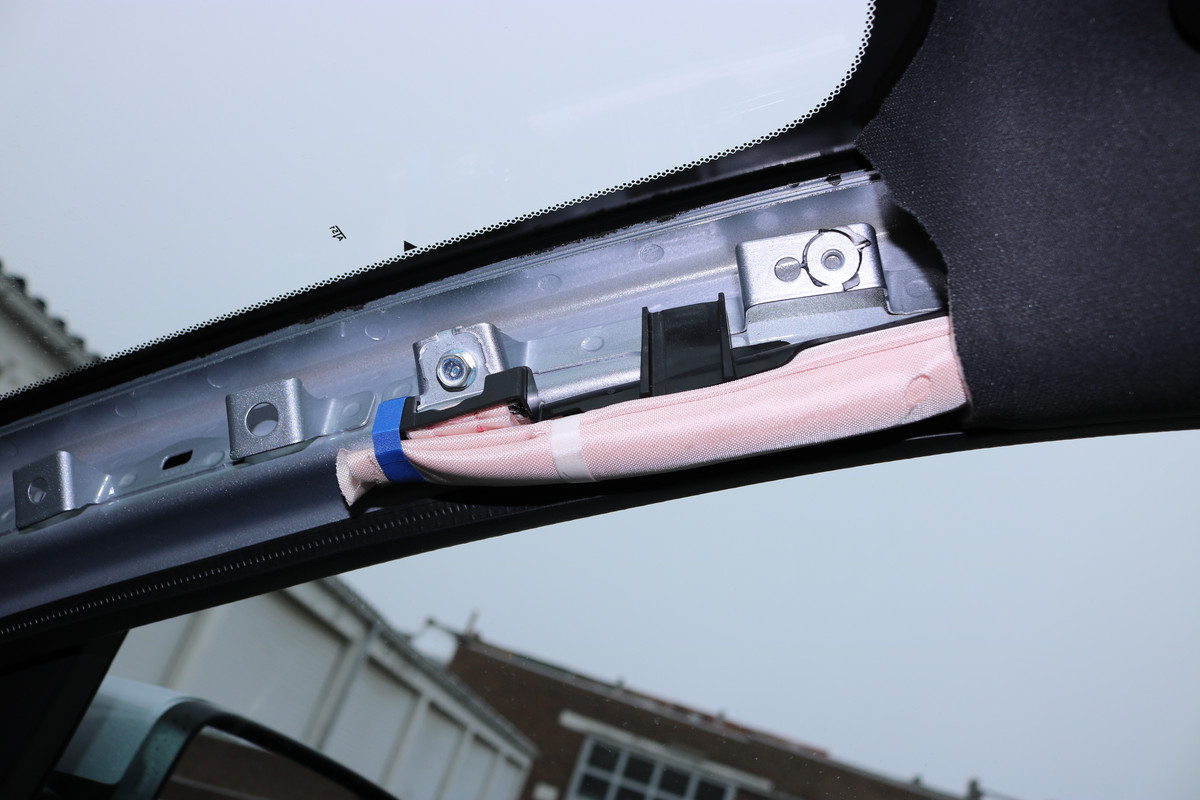

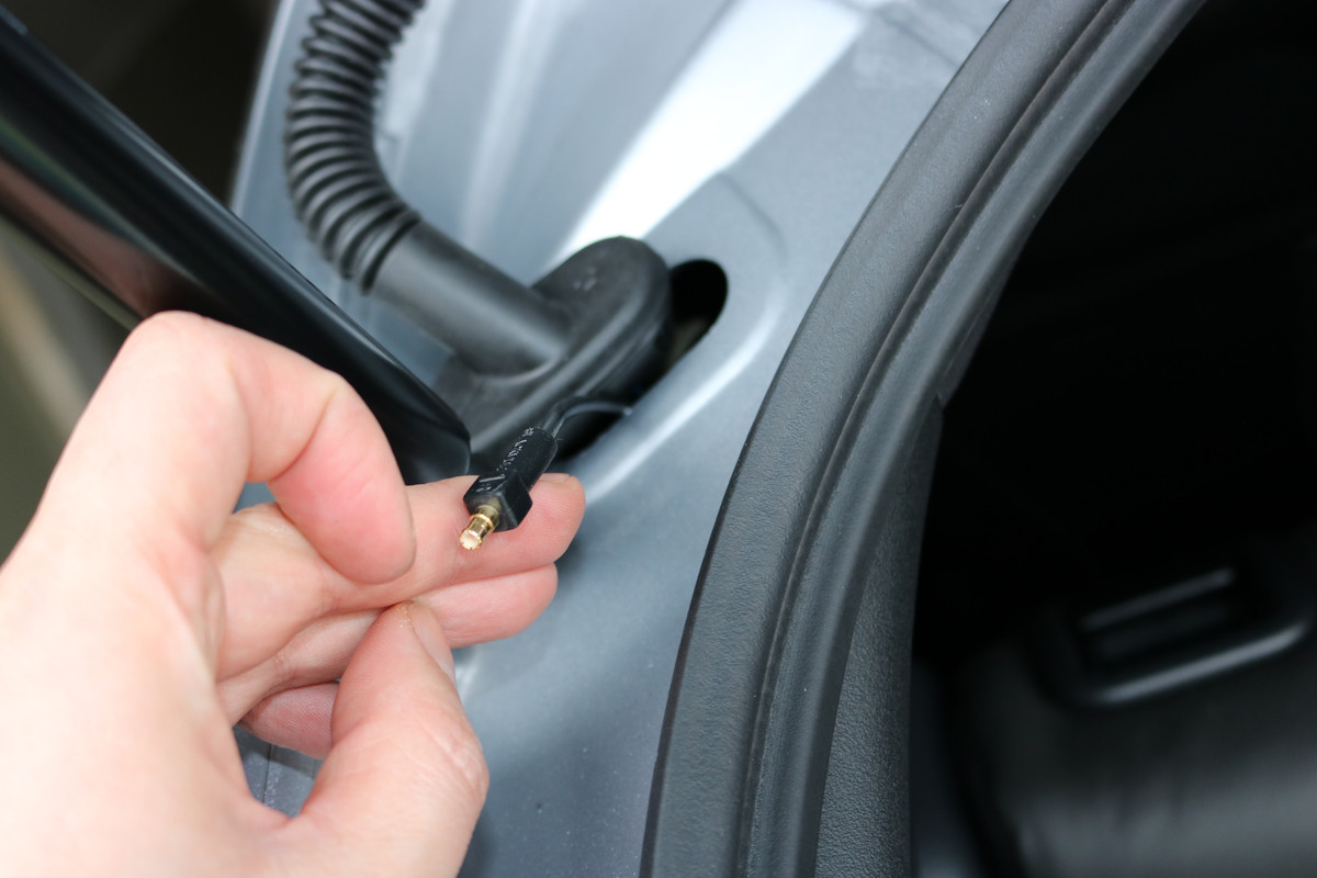

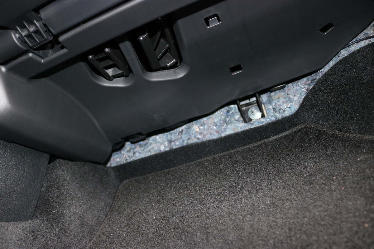

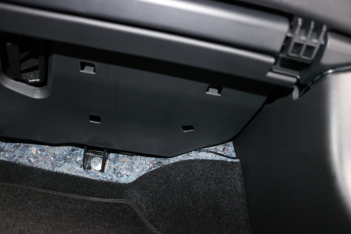

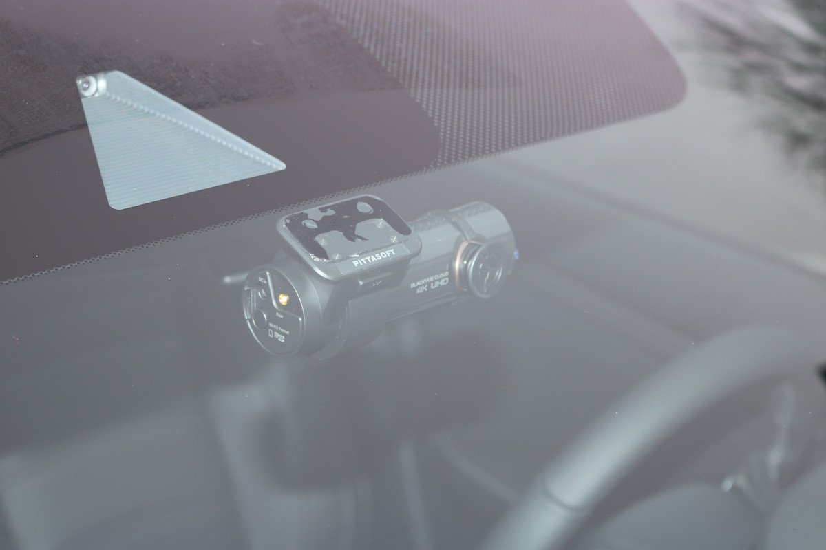

Show us your dashcam set up

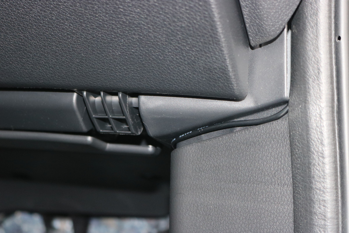

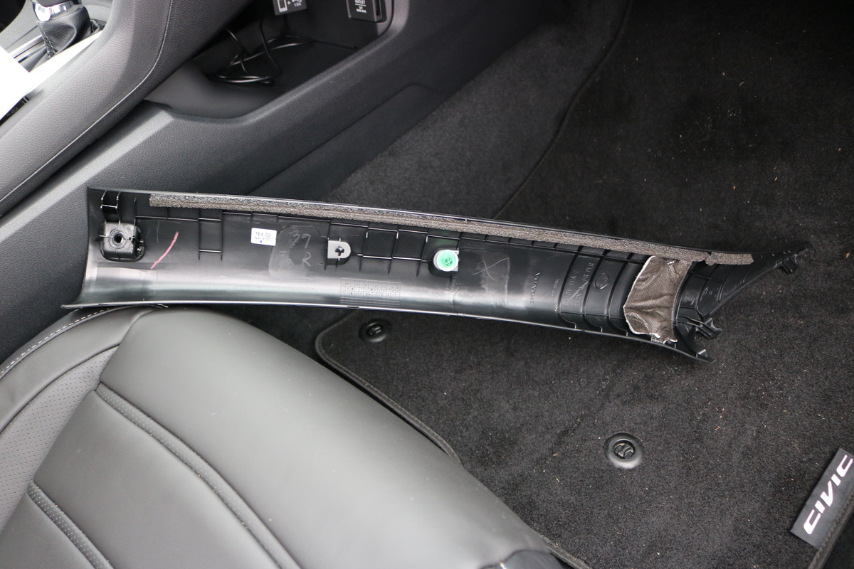

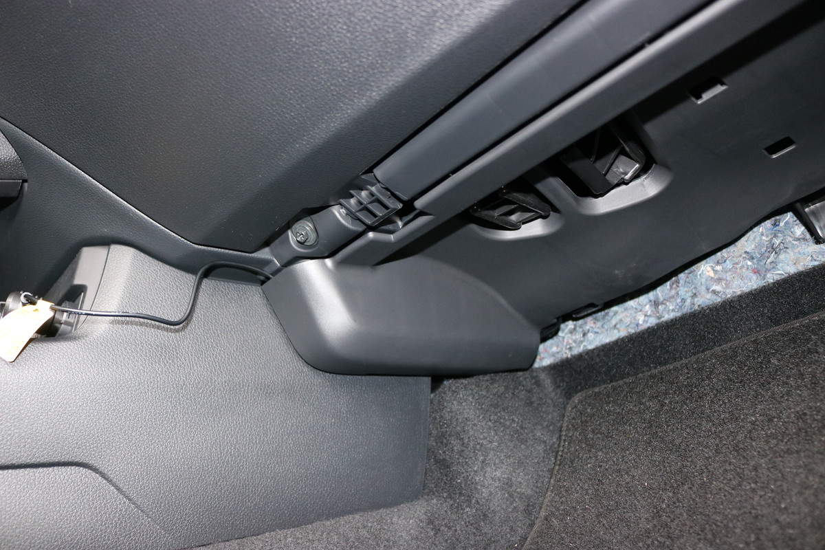

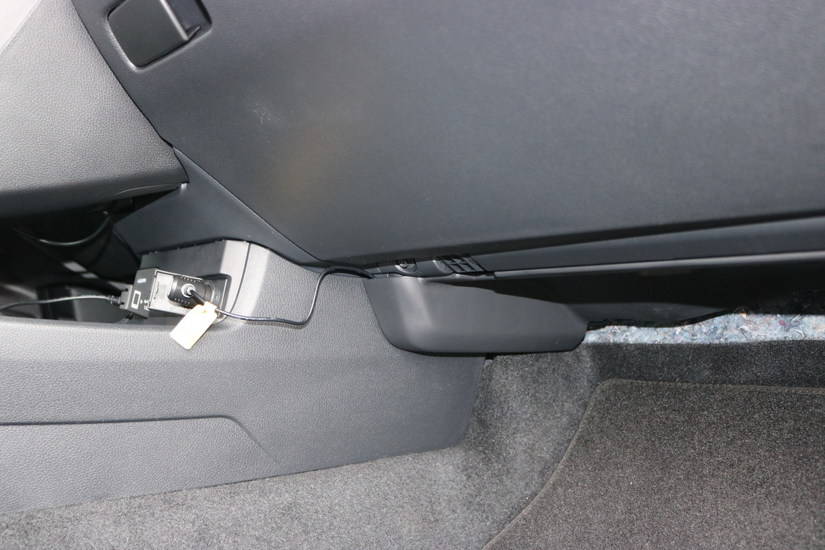

Dashcam installation.
BlackVue DR900S-2CH (4K at front) yeah yeah, 4K is not necessary pehaps, but its my money
Only did the front, because didnt wanna bother with removing trim the same way I did for the front to get that long cable from front to rear.
If I am in the mood I might visit the dealer or a 'specialst' to install that cable for the rear camera.
Also a possible future option is an optional external LiFePO4 battery for the parking mode.

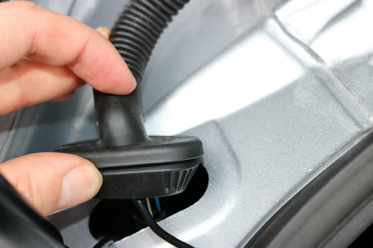

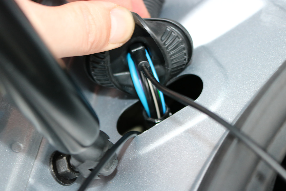

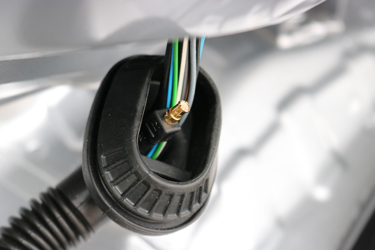

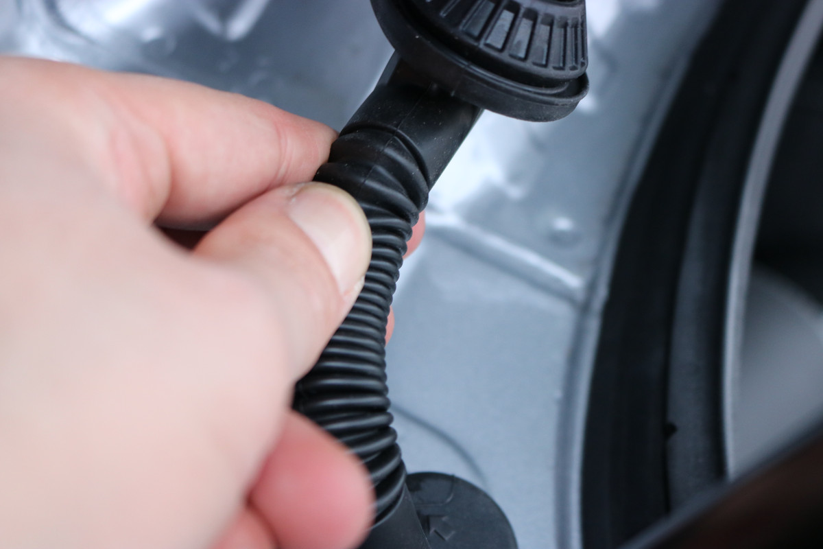

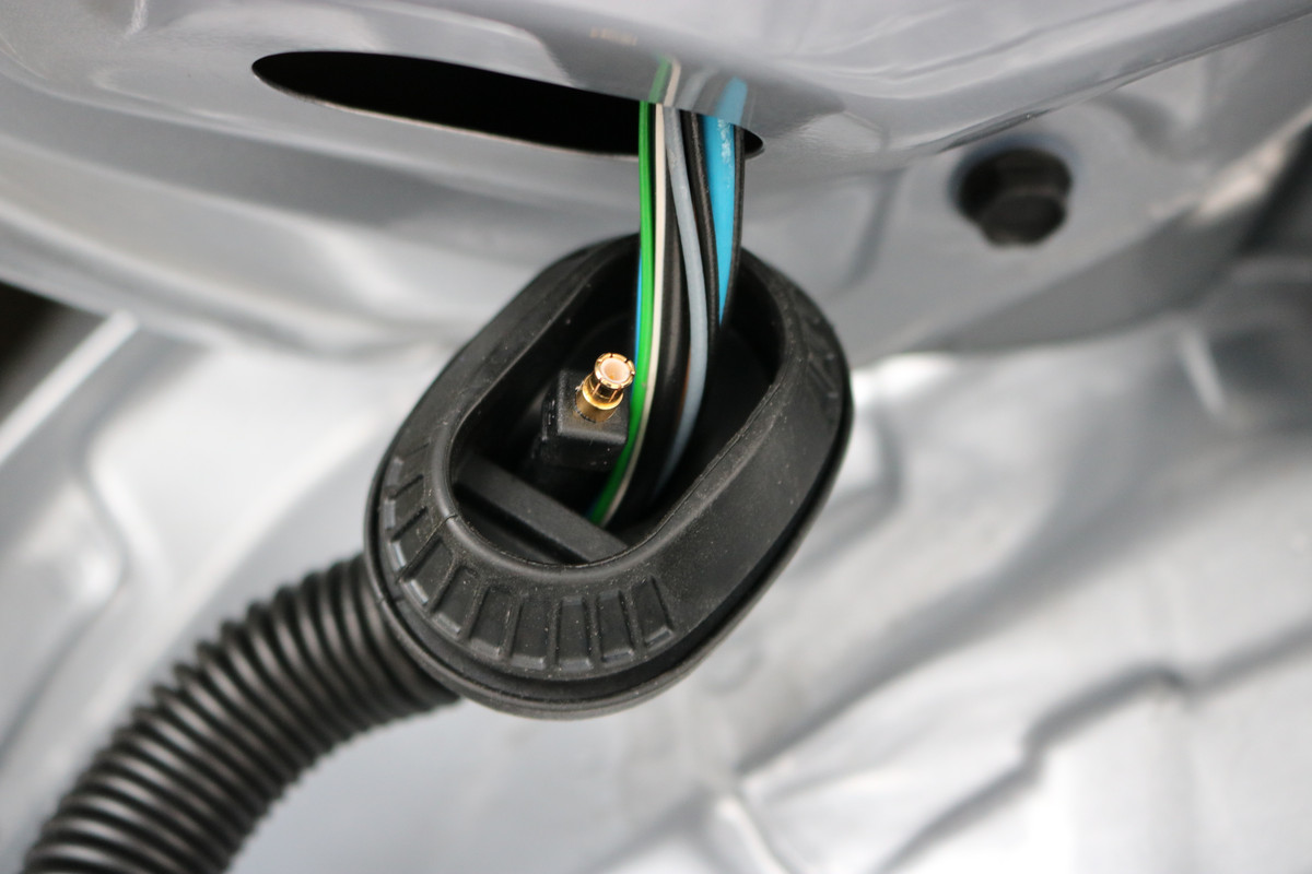

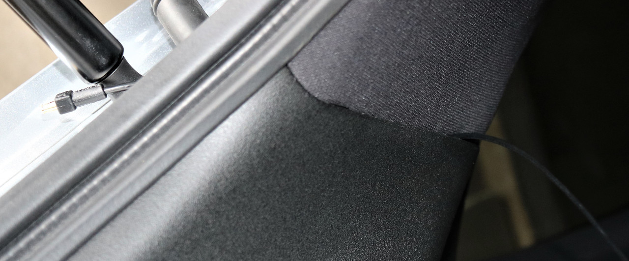

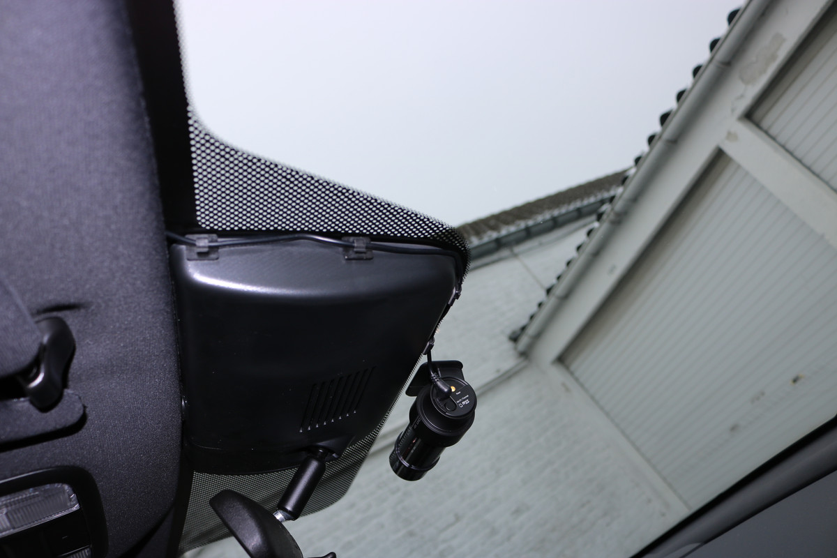

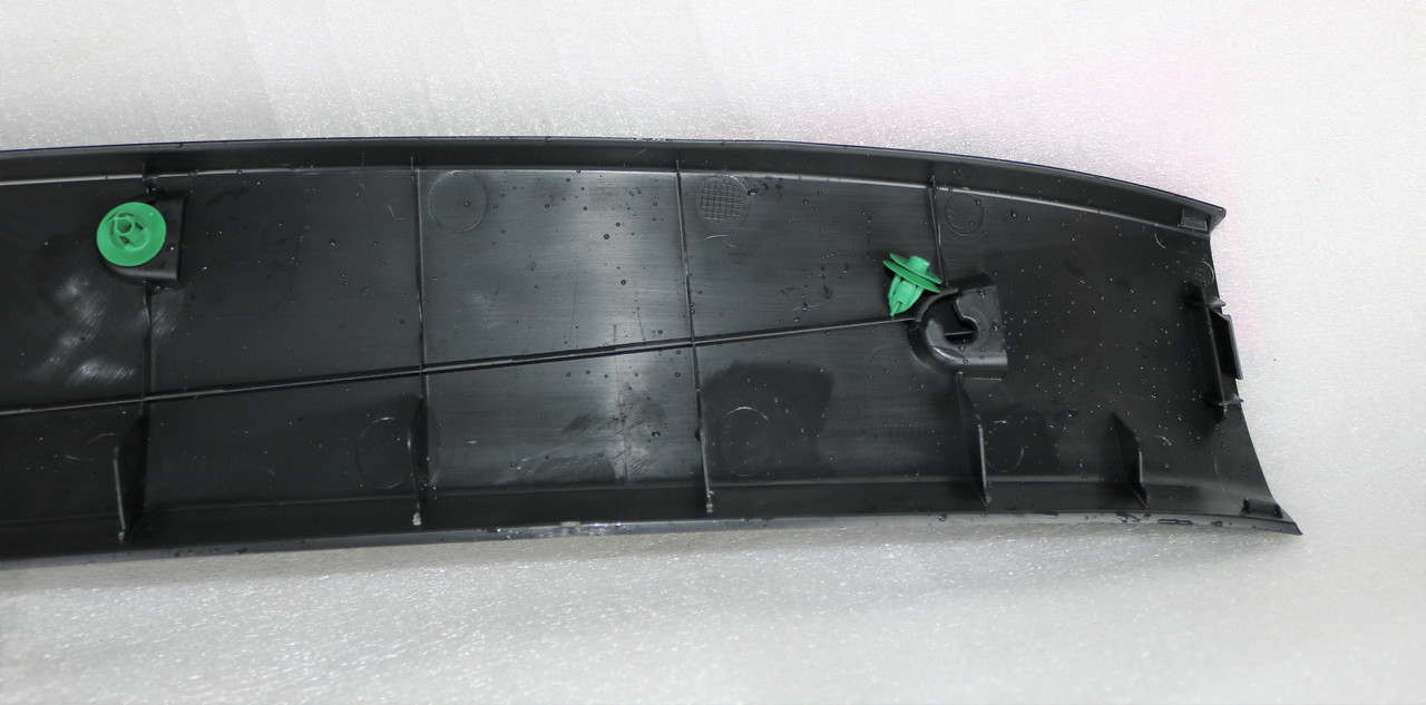

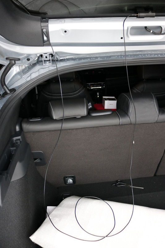

Next up, the notorious rear camera installation
At first when looking at tackeling the black rubber tube, I thought, this is going to either take a lot of time and frustration or some genuine Macgyver insights.
But to be honest, I managed to feed the cable through the black tube in about 5 minutes or so, no guiding cable, no lube, no nothing.
I think I was lucky that the connection point of the cable was rather thick, because that allowed me to push the cable bit by bit from the outside, and thus I worked my way slowely towards the other side
This method looked already like a bad idea with the pointy steel tip, to be pushed blindly into a tight rubber tube full of electrical cables, so we left that path

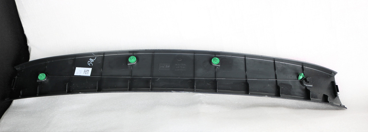

I did broke a green clip...
I contacted 5 differend Honda dealers around my neighborhood, but so far only one replied (its Saterday afternoon now here) stating they dont have such clips in stock
But they could be ordered...I would think a dealer has such clips in abundance....
I told him not to bother (I'll await reply of my own dealer and the 3 others, with any luck I can finish the job today)

eBay. I think I bought 25 for peanuts. (broke a couple of mine too).
You will be shocked at the price Honda want for a iddy biddy bit of plastic.

curious to find out...turns out 1 of the dealers I mailed has em....shops are closed now, so monday it is
edit: Sunday it is

Well done routing the rear cable
