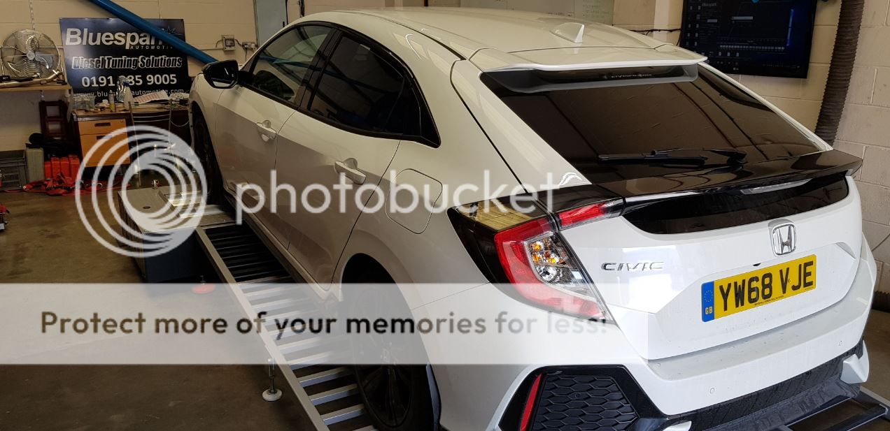

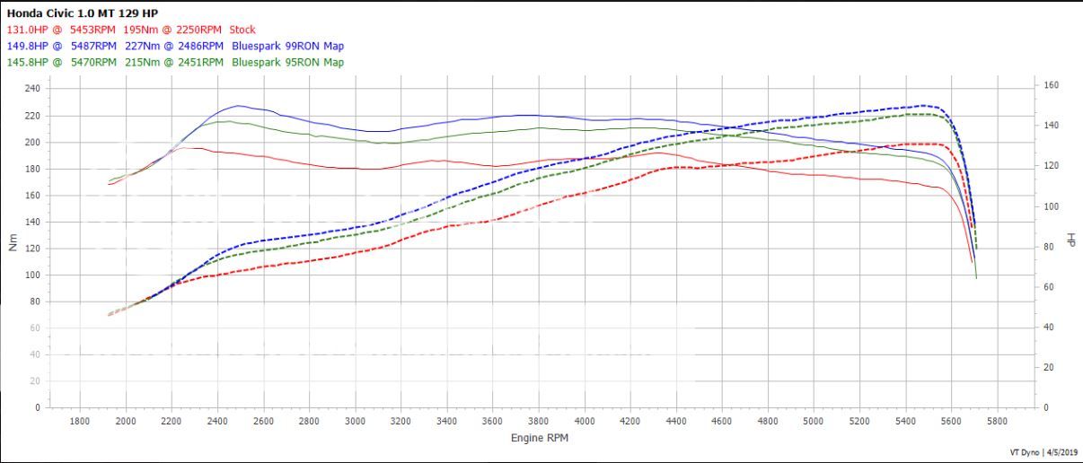

So had my visit to see Edd and the guys and Bluespark today. Very friendly and professional bunch who spent the whole afternoon working on the Civic to find a suitable state of tune.
Edd was surprised at the amount of standard boost already on the engine (20-21 I think he said) so was reluctant to push to more than 24, so the gains are good, and noticeable, but not possibly as much as expected. Still, there's a good gain in output, economy was certainly no worse on my 100 mile trip home, and fuelling felt smoother throughout, especially on a couple of sections in the rev range.
Standard car showed 131BHP & 195NM, 99RON map 150BHP (149.8 actually but hey, let's round up!) & 225NM, 95RON map 146BHP & 215NM.
A great and thorough job all round. Thanks to @[email protected] and the guys. I came away very happy.
Here's the dyno graph and other pics.....

That's not bad, 150 hp for a 1lt engine and torque of 166 lb ft and they can be purchased for only 174.99 less members discount

For the price I would say so @D84rk_Knight . Edd said he could have used the multi channel box and probably got a bit more power and an even smoother torque curve but it would have doubled the cost and probably put most people of purchasing one. So for 140 (I think that's what it is with members discount) then I'd say it's worth it.

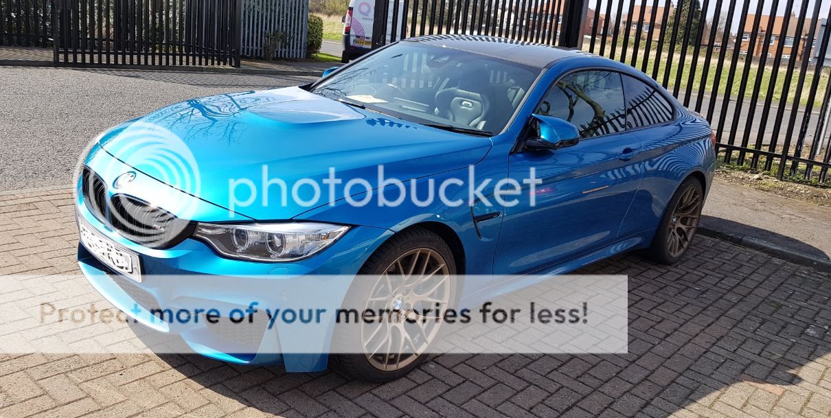

I can see you have taken a picture of the courtesy car too lol

Yep, wanted to capture the awesome Ibiza estate @rogp1 !
