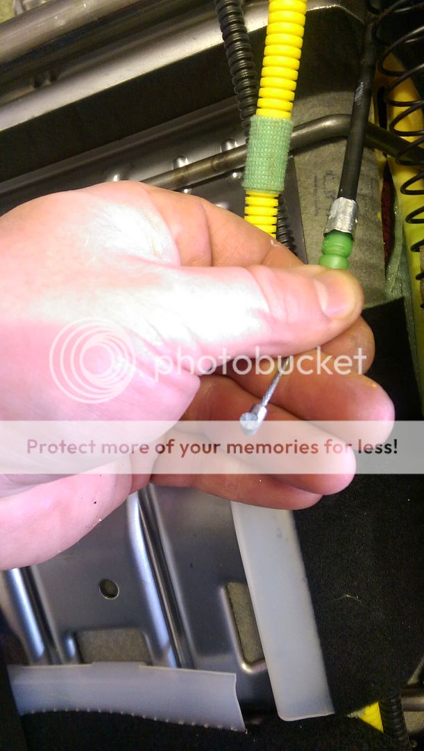

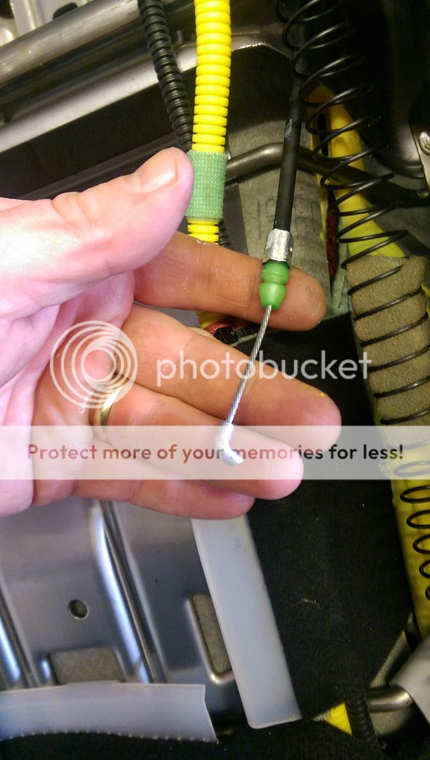

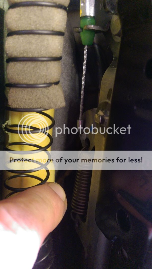

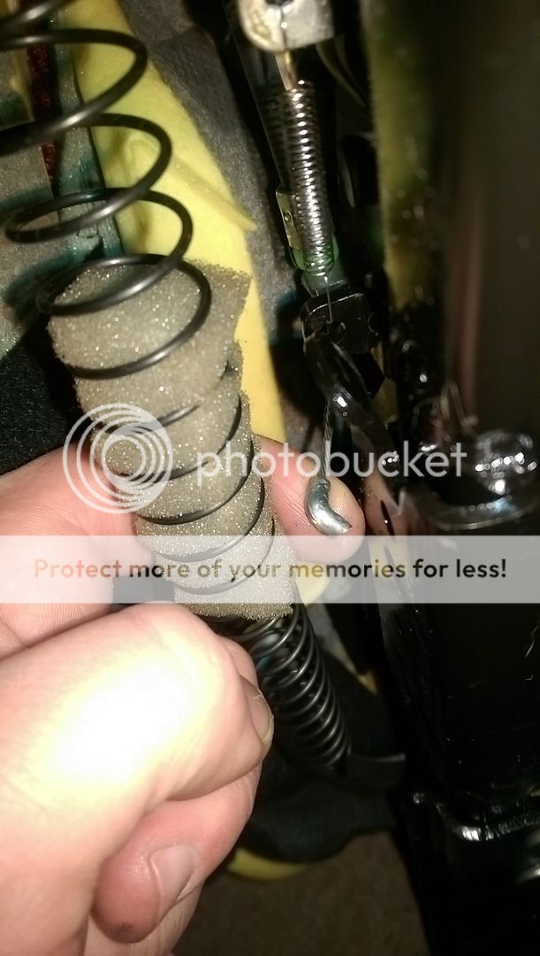

Anyway, seat out and upside down and inspect the mechanism as to what is going on, fingers crossed that it's just something stuck and needs lubing or a foreign object is stuck somewhere. Immediately I notice that the right hand runner operates as it should, but the left hand isn't moving. Spy a couple of cables and hey presto! Damn. The end of the cable on one side is snapped.
This one to be exact.
It should be in this lever, like this
However the end of it has snapped off. I got the cable out of the holder
You can't buy a separate cable and to be honest I wouldn't want to try to swap it as the rest of it is quite buried under plastic and seat trim.
So it's just something I'm going to have to live with or try and find another seat. To be honest I think it will be the former, as none has been in the back yet.

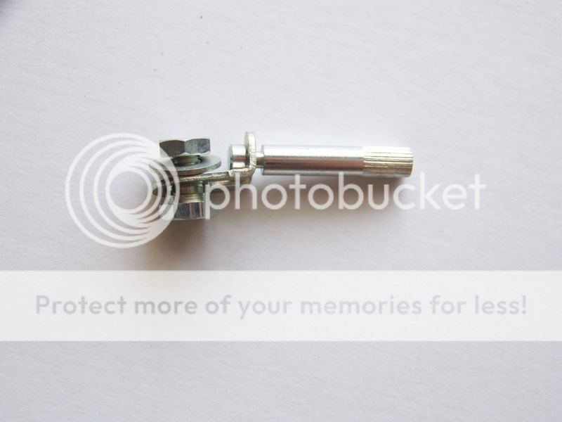

Just for future longevity of the thread as the eBay link won't stay live forever, the bracket part I used is a:
GEAR LINK for Sturmey Archer bike
6,767 Posts
Discussion Starter · #10 ·
Fixed this yesterday! Such a good find, thanks again Loxy :)
Nice one, glad it helped! :thumbsup:

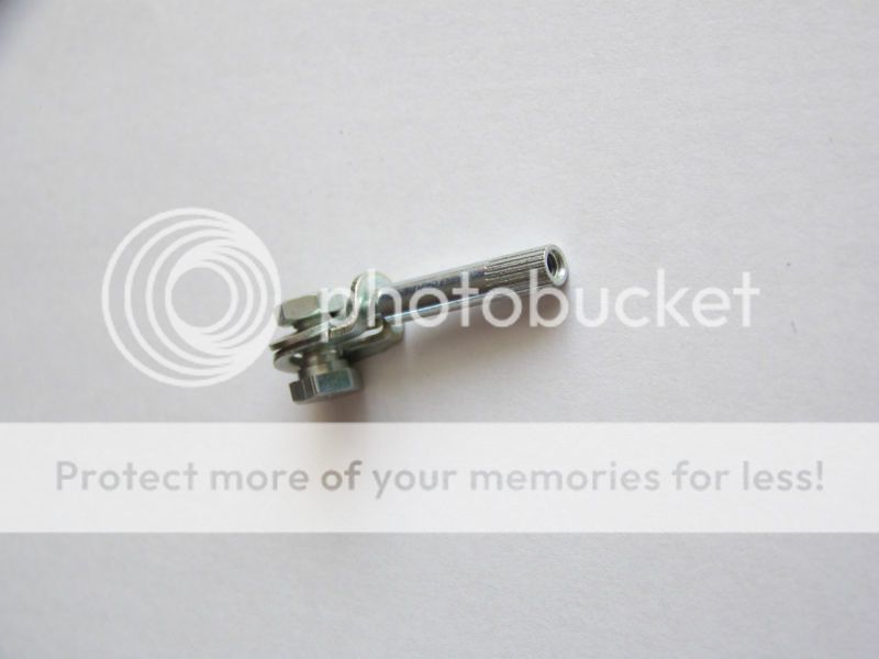

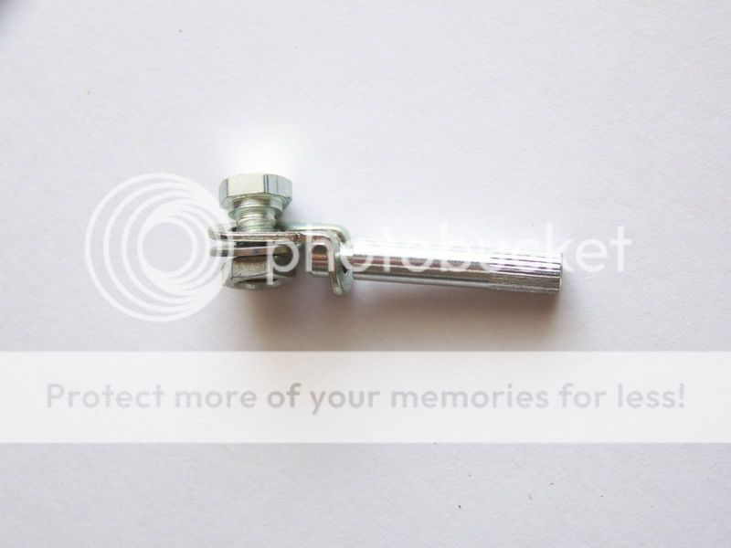

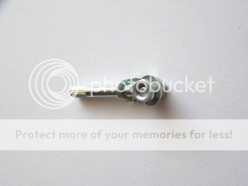

Pictures of the part for future reference. The metal rod isn't used and can be discarded.
