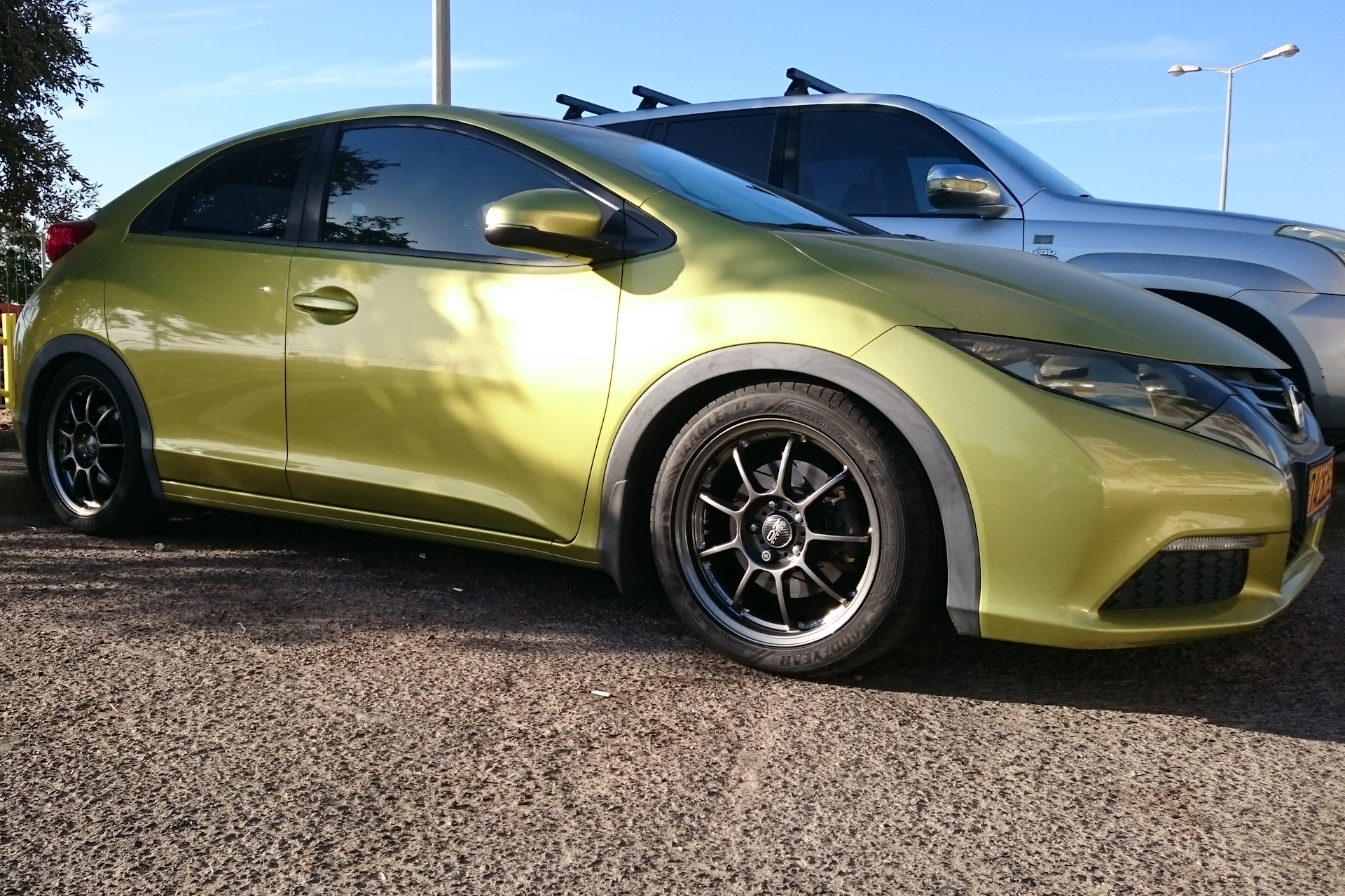

469 Posts
I Eibach'd my 9G and have 18" wheels on it and while it is definitely harder then stock it's still quite usable on a daily basis. It's not too hard for normal road use.

I did ride a 8G for a day (while my 9G was in service) and it was horrible to be honest. I guess the Eibach'd 9G is firmer but less crashy if that makes sense.
