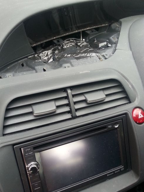

Next up was to do something about the head unit. Two things bug me about it; firstly no way of connecting aux/USB/ipod and secondly no Bluetooth for calls. So, more time spent on here looking at what can be done, I decided to go for a new unit rather than any kind of add on for the Honda one. Took the plunge and bought a unit/fascia /connects 2 loom from here and away I went. I must say that the write ups on here are fantastic and have been so helpful as have some of the chaps that have returned my pm’s when I’ve been stuck – thanks to you all, especially Syx and Liam (x5252x). What was quite a panic though was the HU asking for a password which the previous owner said was not needed, but was defo required to get the HU to work. The internet came to my rescue again though with a test mode hack that allowed me to find said password and all was good in the world again.

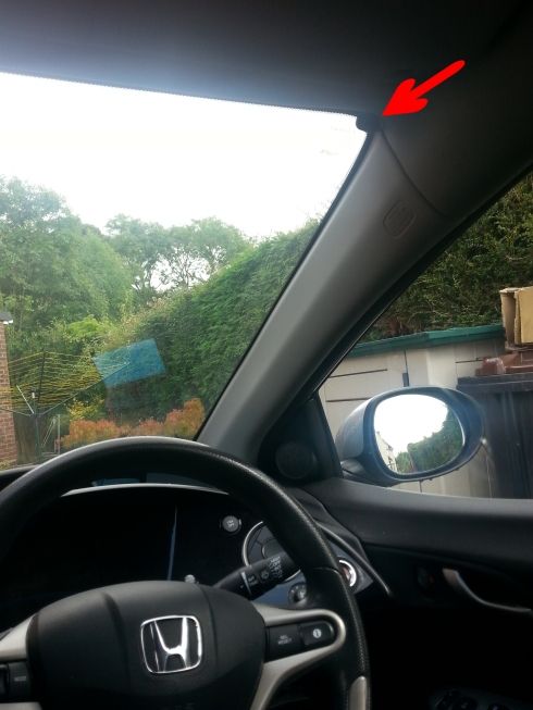

Installed headunit, with the GPS under that flat dash section and the microphone in the top right hand corner of the windscreen

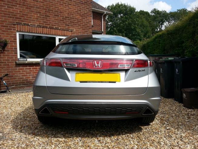

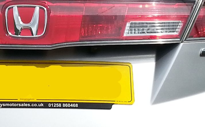

I then bought a wireless reverse camera, hoping that being wireless it would be easier to set up than running wires through the car. Nope! It proved to be a bit of a mare, and when I did get it trial fitted the connection caused the picture to flicker and drop out – not good. So I made myself up a long enough run of cable and made it into a hard wired system, cutting out the sender & receiver. It was also originally a number plate mounted camera, which I didn’t like as it was too close to the tail gate handle, so I converted it into a one I could fit under the rear centre light unit and ran everything through – and it now works perfectly, although I can’t work out why the VSS isn’t telling the HU to get louder at speed. Maybe it’s a setting on the pioneer AVIC-F940BT, but I can’t find it anywhere – any pioneer HU owners know?

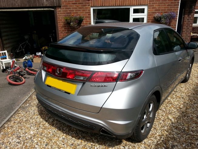

fron the back the camera is not very noticeable ....
you can just see it here ....

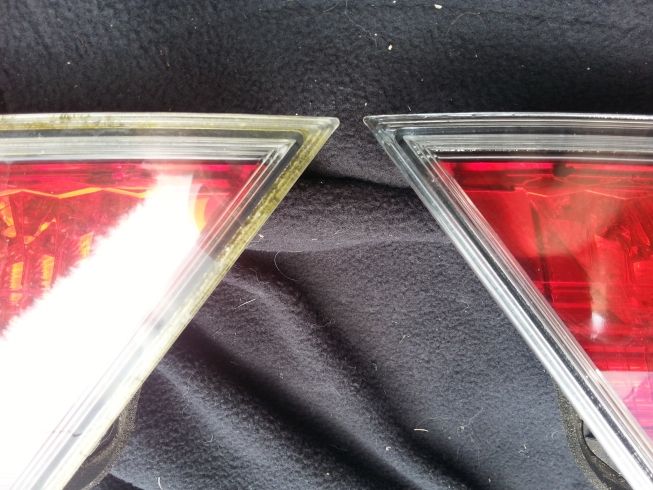

So, next ….. after reading through other projects I liked the idea of ‘de-tangoing’ as it seemed to make made a big difference. Three days later a box from Cox’s arrived with two new clear light housings and an EGR gasket kit. The EGR clean was not nice on the knuckles. I had hoped to find it 60-90% blocked and thus notice a massive improvement as some of the other civinfo users have found, but alas it was only 10-15% so I doubt it’ll wow me much, but at least its done now.
De-tangoing occurred last week and was again a very easy mod having read through the fab posts on how to do it easily. I think these and the grill have made a definite improvement.
even just cleaning out the surrounds of the lights made a difference - check out the green gunk that had accumulated around the edges of the centre sections! half an hour washing with a toothbrush made all the difference!

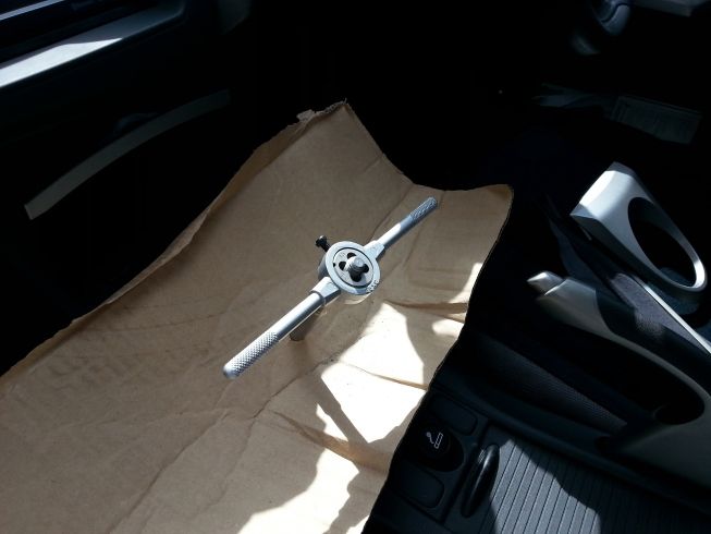

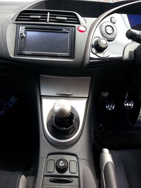

also - bought a Type R gear knob from Tezza - thanks mate and a gaiter....
Used a die to extend the thread down a little and also cut it so that the knob details will be horizontal when the knob is fully tightened, so no need for a bolt.
all fitted up and the fascia back in after the head unit install... really pleased with it all...

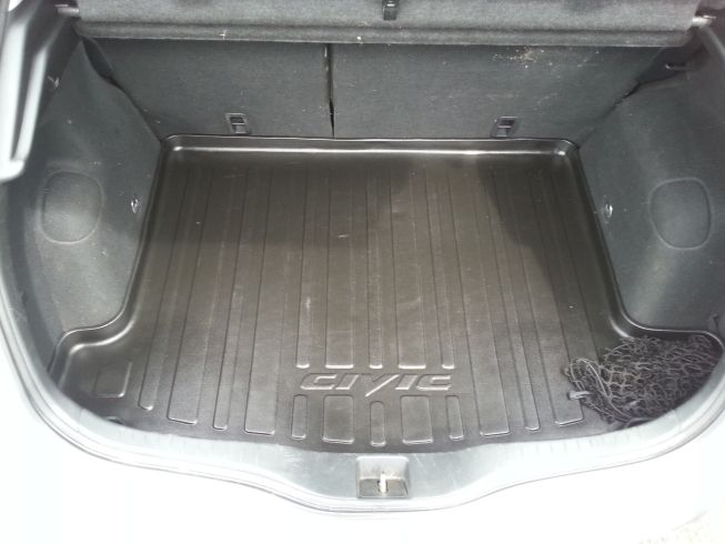

other bits bought .... can't be doing with the 'gunk' thing so got myself a spare from cox's....
and the bootliner came from stuk20a2 - thanks matey. I use the car for dump runs and general family haulage so wanted to protect the boot a bit...

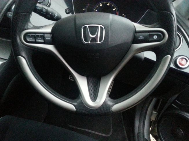

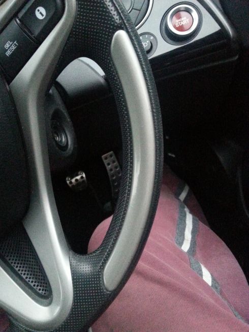

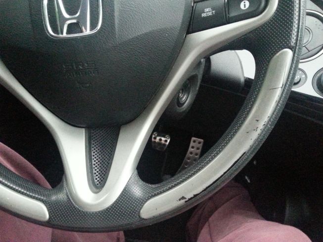

so today I replaced the outer trim on my SE steering wheel. Written up a 'how to' as although it looks like it should be easy, its a bit of a pain, so hopefully the mods will add it to that section...
managed to adapt the left hand piece I bought from Chris on here last week into a right hand piece ....
steering wheel went from this ...
to this.....
really pleased with it :D
