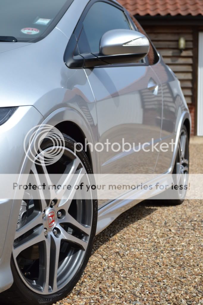

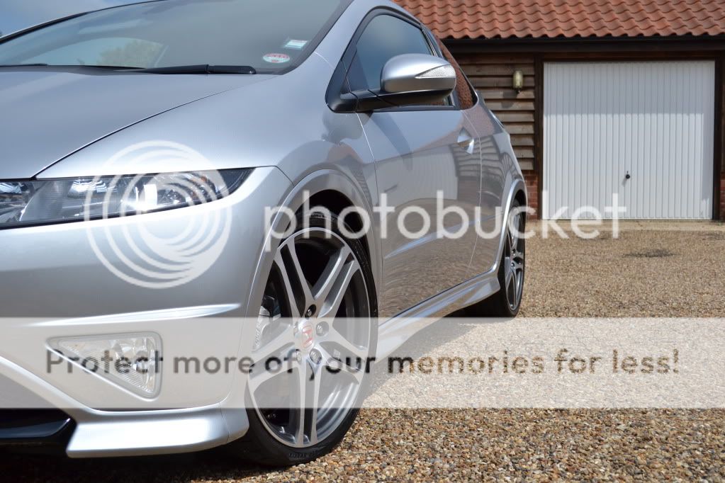

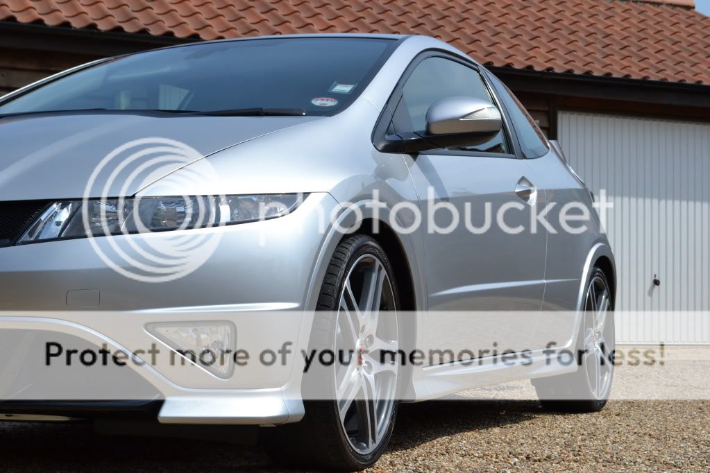

Finally got round to a giving th e Civic a protection detail last month this time wearing Wolfs Body Wrap.

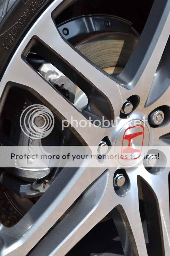

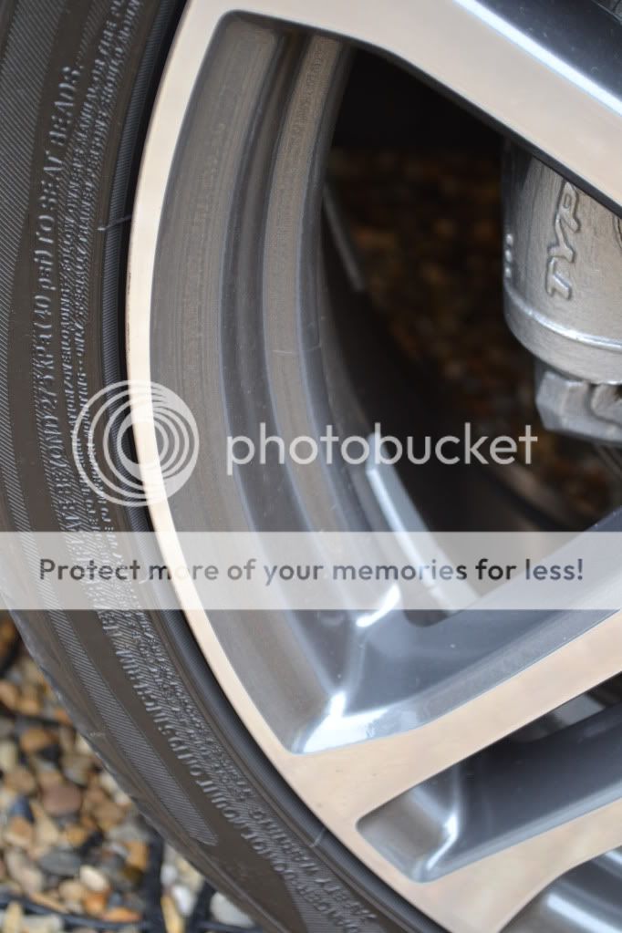

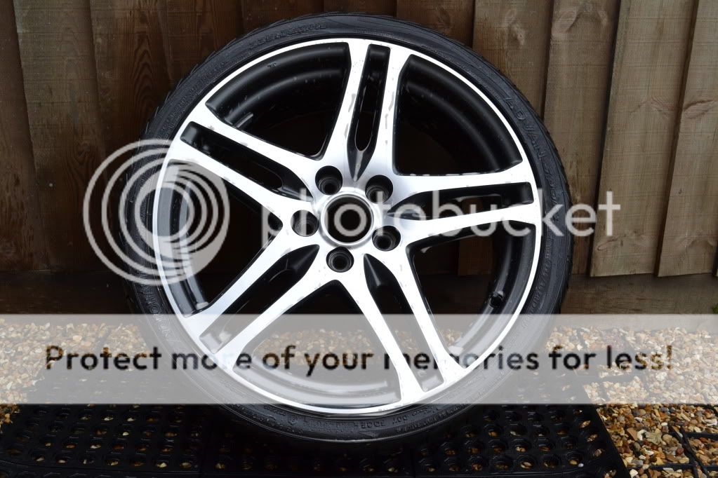

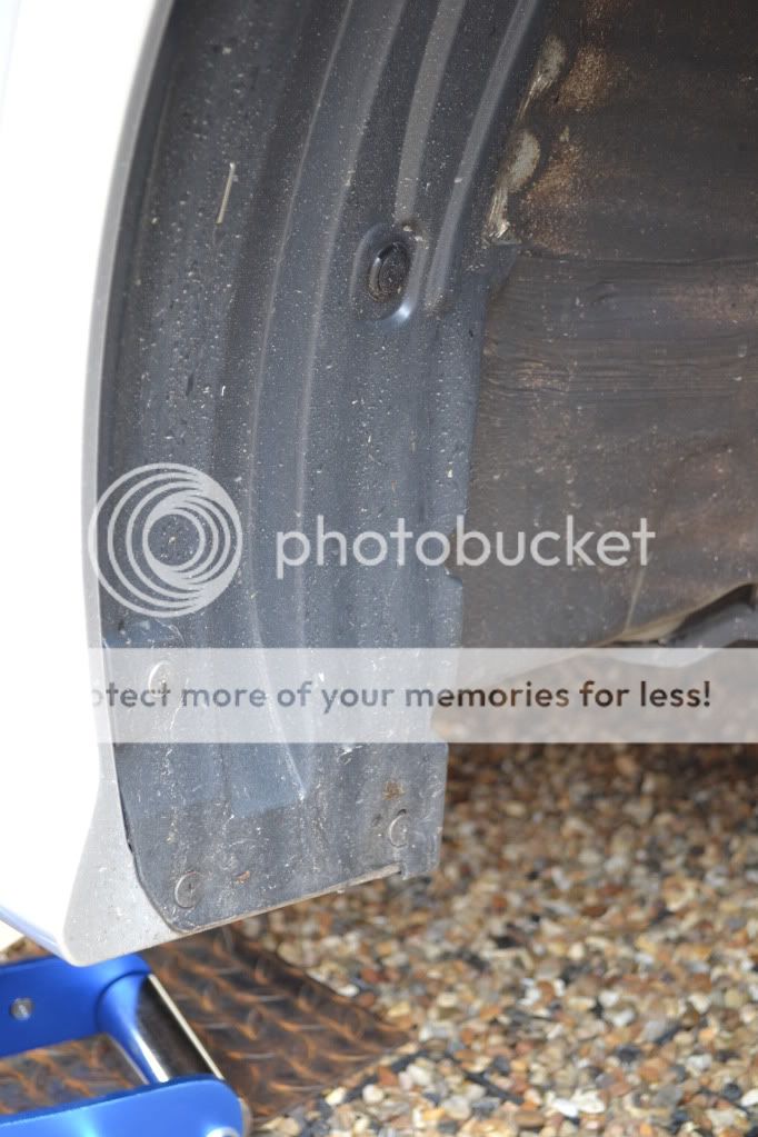

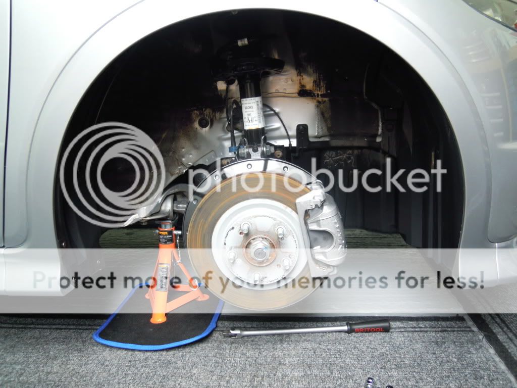

Wheels clean with gloss it wheel cleaner 1:4

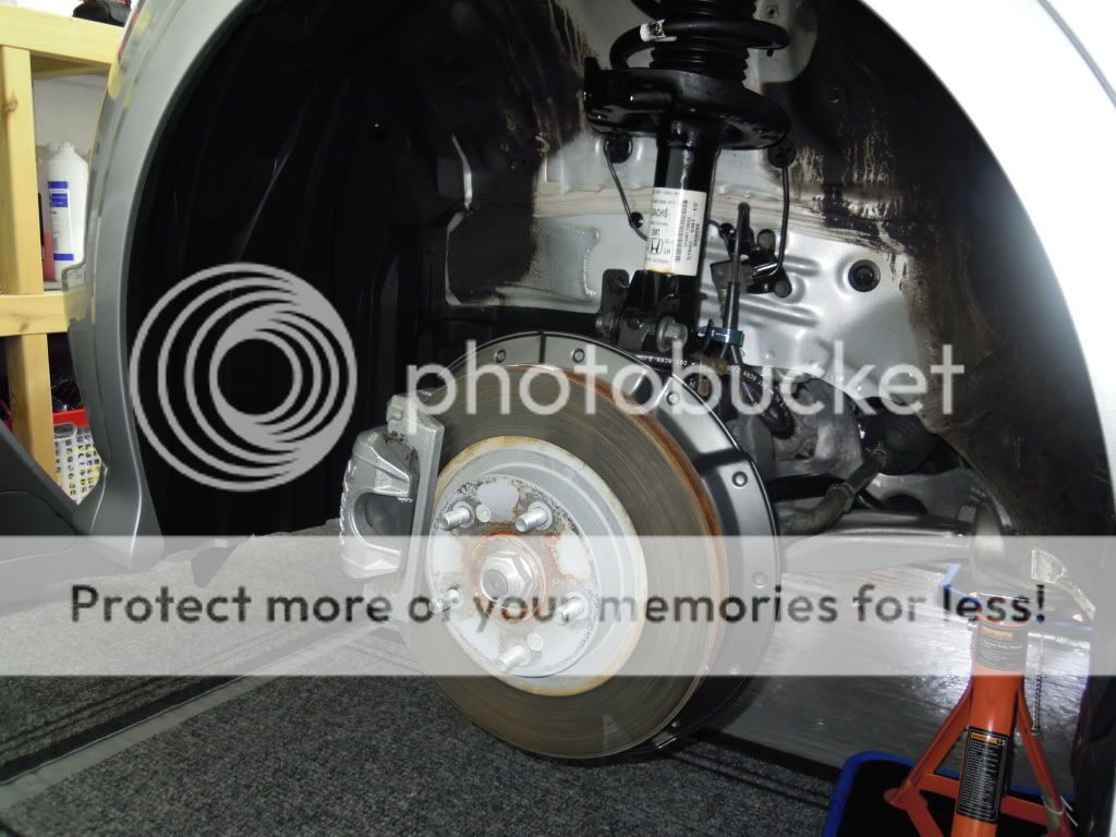

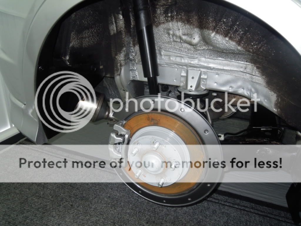

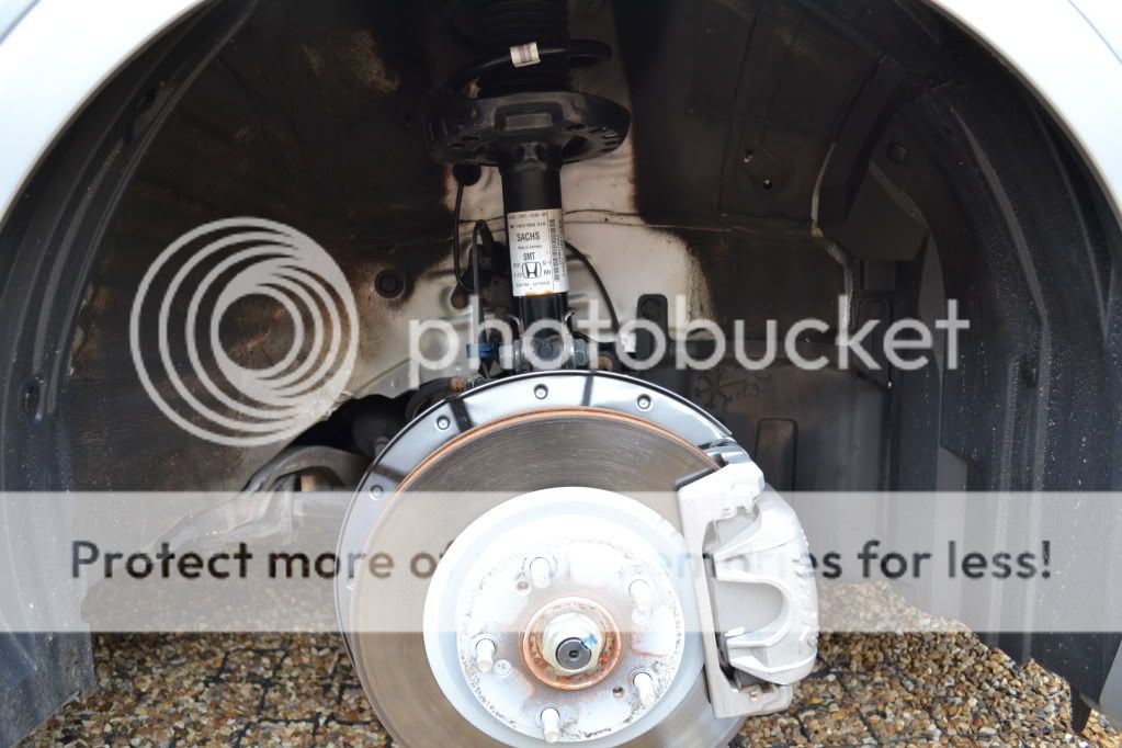

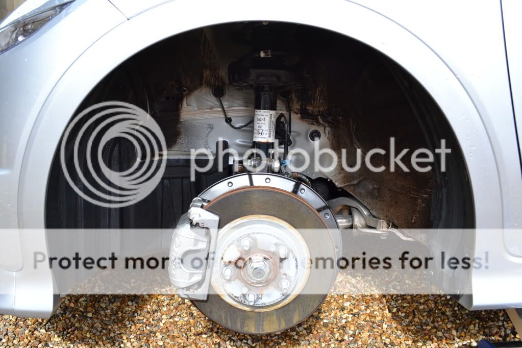

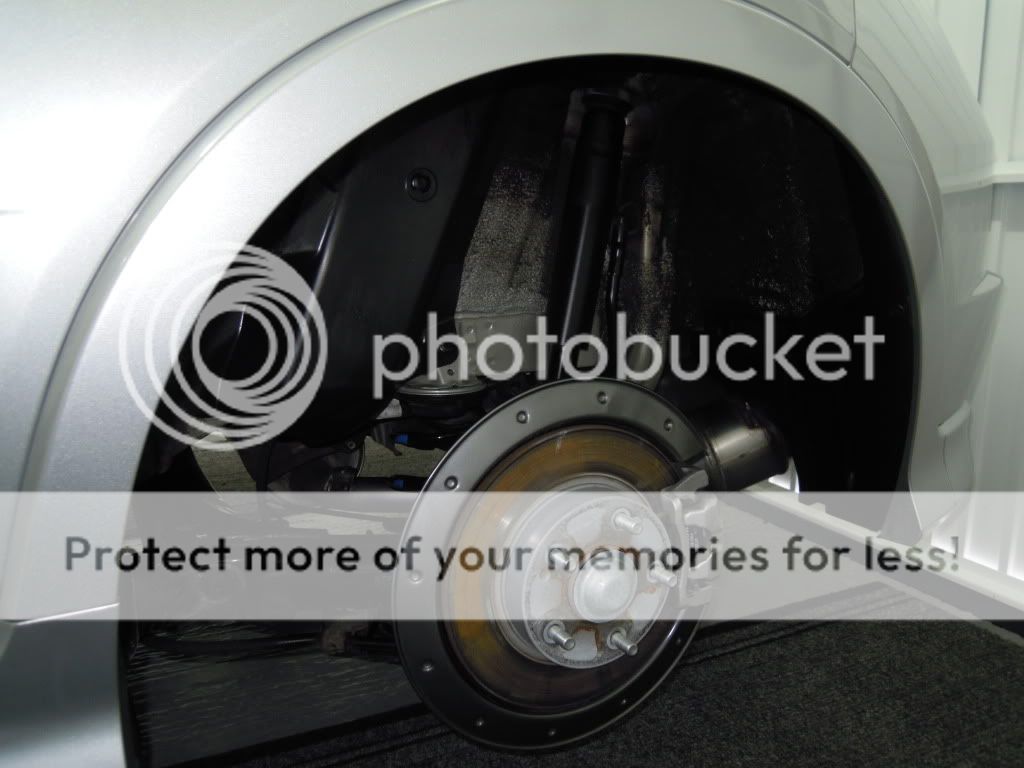

wheels removed & arches, suspension and brakes clean with Megs super degresser1:4 and tardis
Wheels clean again with Gloss it, Iron-x & Tardis
Tyre scrubed with Megs Super degreaser 1:4

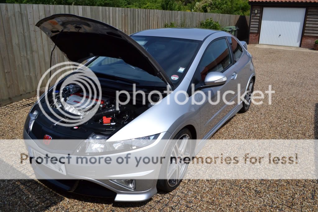

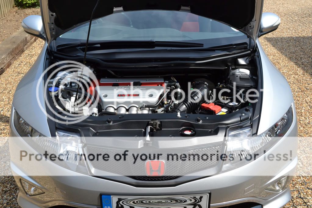

Engine bay wiped down with APC as this had been cleaned earlier last month and dressed with 303

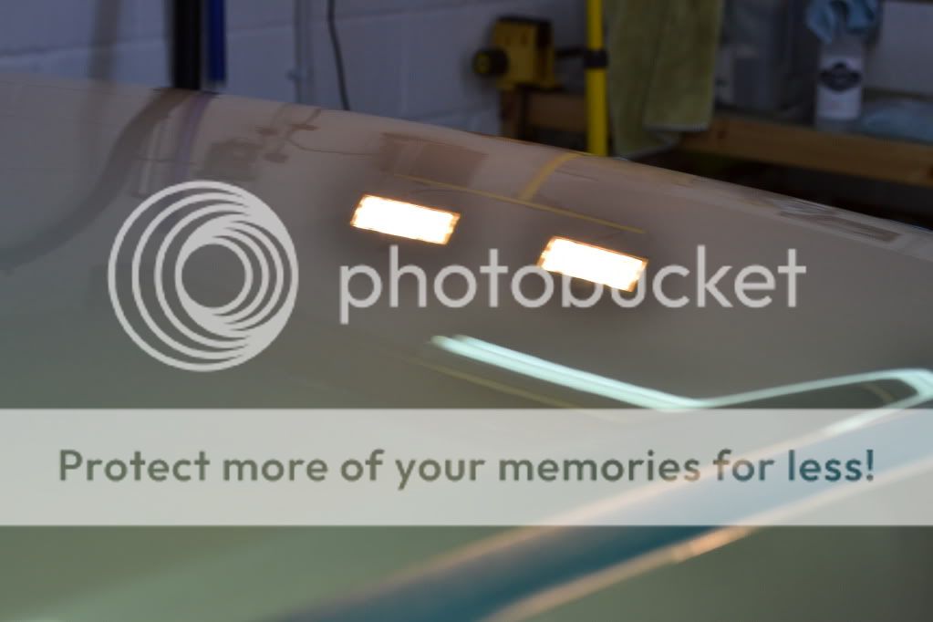

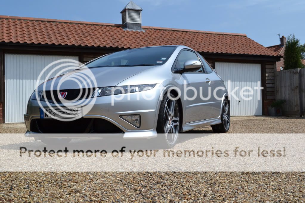

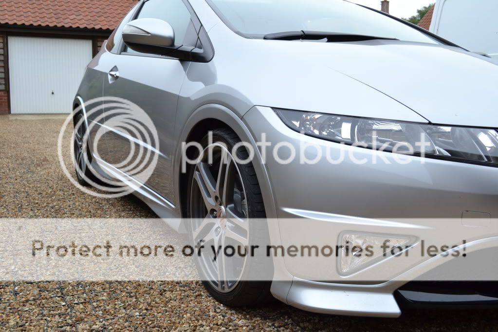

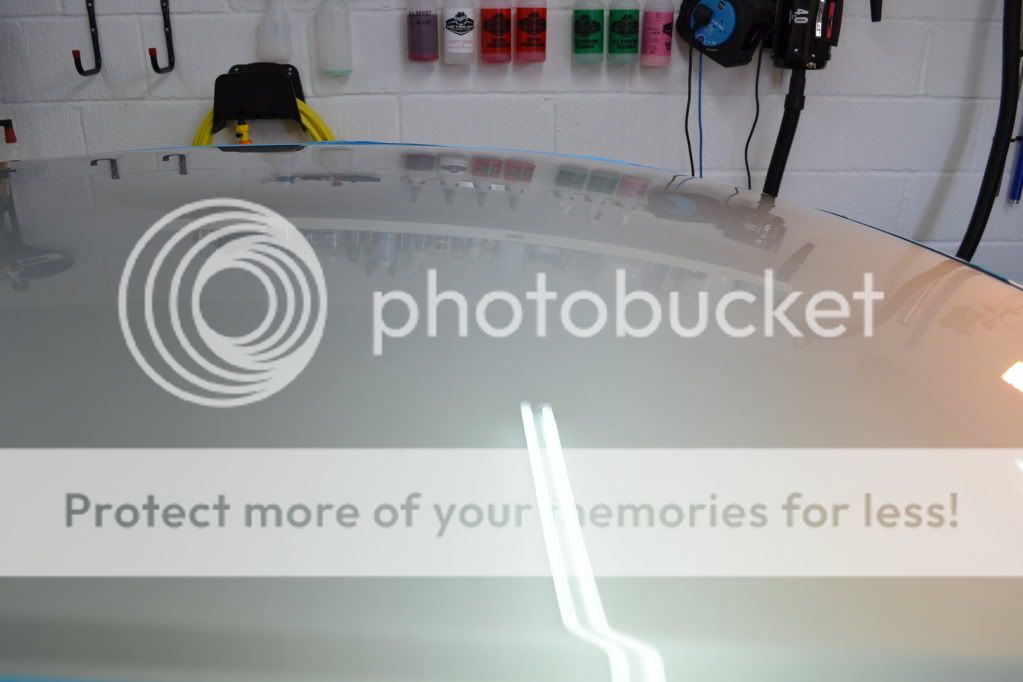

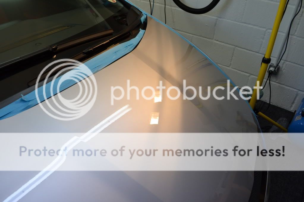

Taped up and enhanced by rotary with Menzerna Super finish 85RE to remove faint swirls
Wiped down twice with IPA

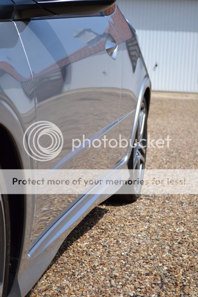

3 coats of Wolfs Nano body wrap, 4hrs between first 2 and overnight for 3rd (3rd coat totally unnecessary and caused problems with spitting and residue was a pain to remove)

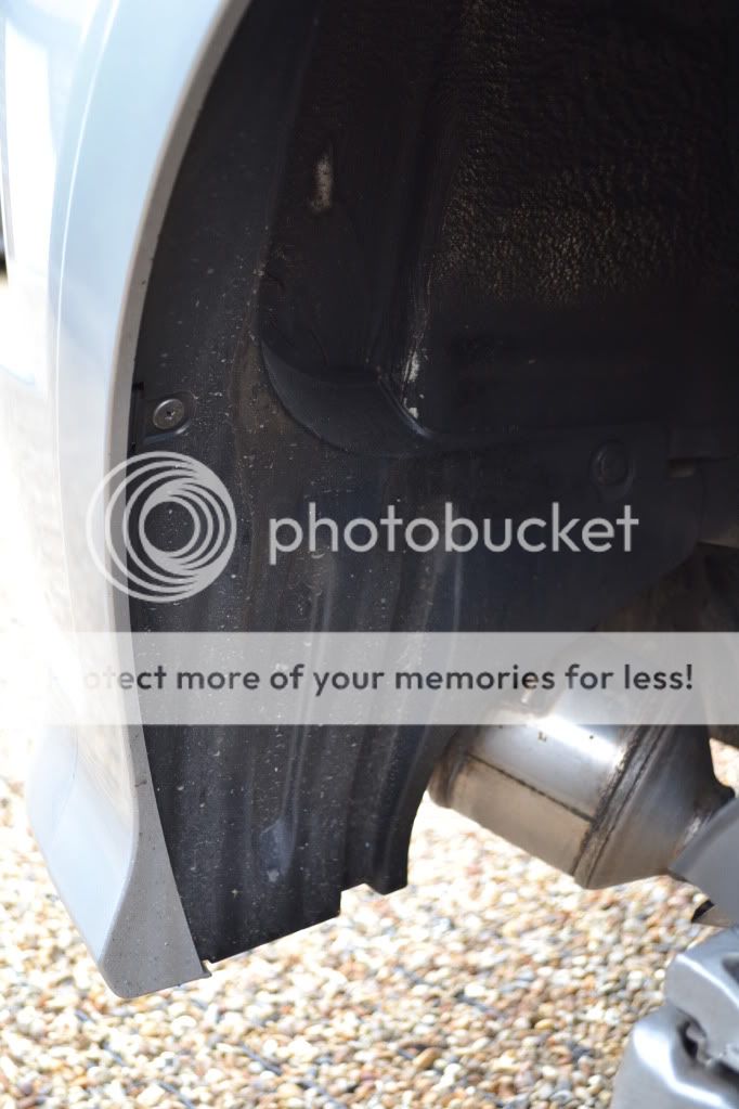

Arches & suspension dressed with 303aerospace
Exhaust & wheel nuts polished with Megs metal polish and sealed with blackfires AMS

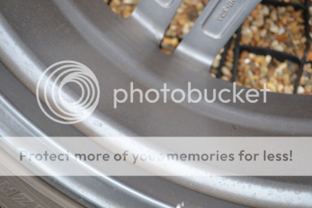

Wheels and brakes sealed with Werkstat prime strong & 2 coats of Blackfires AMS
Tyres dressed with 2 coats gloss-it signature tyre gloss

Wolfs Body Wrap is a sealant and a replacement for wax, better suited to light coloured paint, but will work on all colours.
Will give around 6 months plus protection before you need to top and ideally needs to be maintained with Wolfs Nano shampoo & QD to maintain the hydrophobic coating

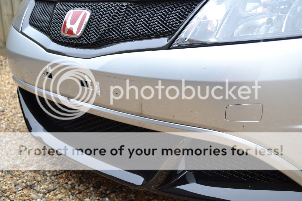

Looks great! I've seen the same pictures on Detailing World too ;)
Did you paint your car's front and rear brake calipers? :D
Thanks, painted with a silver/grey calliper paint from ebay

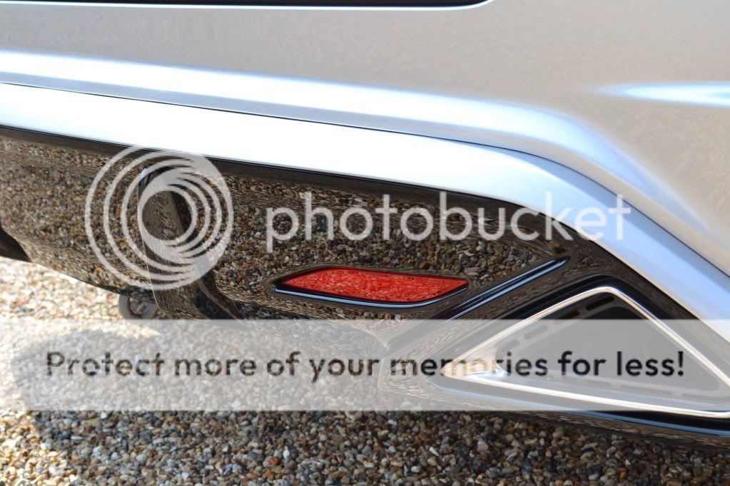

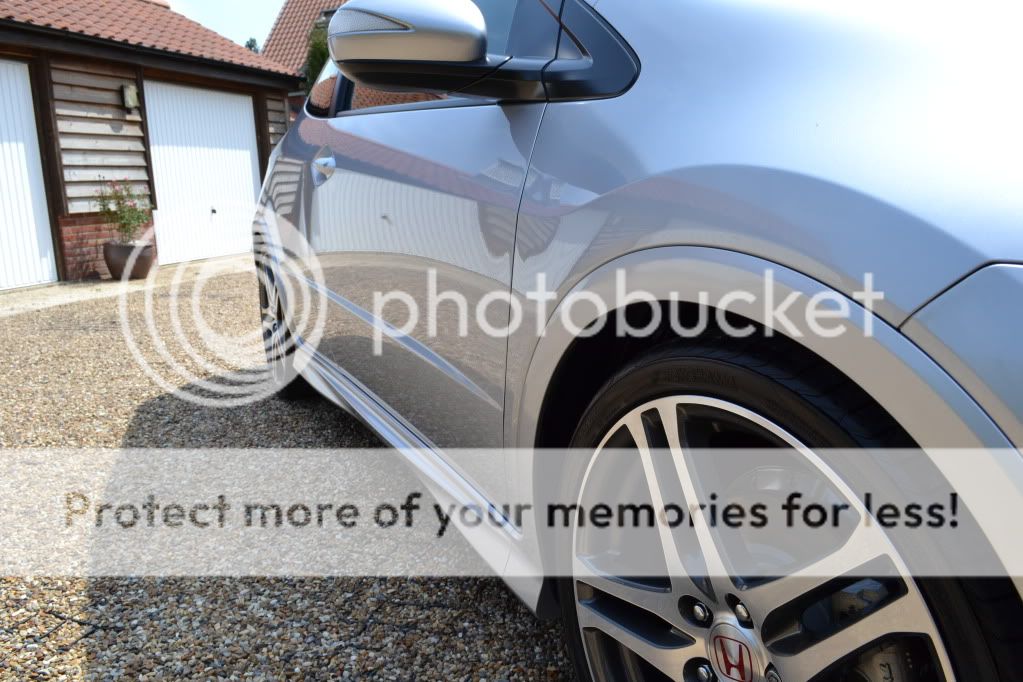

Picture with the close-up of the rear splitter and exhaust is amazing, it looks like the stones are getting on your splitter.
thanks, seems to be a constant problem with tiny stones get flicked up from behind. You'd think being so anal i would have remembered to remove them before the photo!
