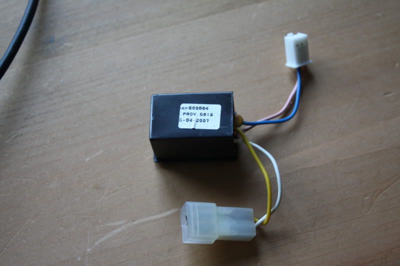

Can you take a picture of the part mate? Has it got any writing or numbers on it?

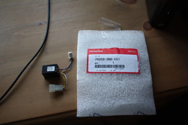

Whats the part that kingkong999 listed then?
Il be happier paying the price you got speedsquirrel!! Can u post up a pic of the part so we can all be sure were talking about the same bit?
Cheers
6 Posts
Hi guys, thats a bit strange what part did I get quoted for then ?, This is the small black regulator box ?, I will have to get back onto the phone to my dealer. I can live with that not paying £60+ for something like that especially if its the wrong part. :confused:
Yh a picture would be great !!.
Type S GT Driver, LOVE IT
384 Posts
Well that's the bit I was thinking about so that's good. Will have to go see them at weekend. Cheers for pics

Thanks Guys,
I just ordered mine £31.43 (inc VAT) and £7 for a touch pen. So my Civic will be all fixed by next week :)
Just need to sound deaden the doors now....
David
228 Posts
Discussion Starter #20
All just to close this one out I can confirm the part no speedsquirel posted is the correct one and fixed the issue a treat. Well worth £30 :)
