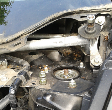

As I've only use of one arm took the cowling off around the screen, adds 20 mins extra strip/fit but access to top mount less of an issue for me.
[URL=http://s233.photobucket.com/user/delphi_bucket/media/cowling-removed.png.html][/URL]
Thanks to my neighbour who helped me lift the front struts back in when he spotted me struggling :)
