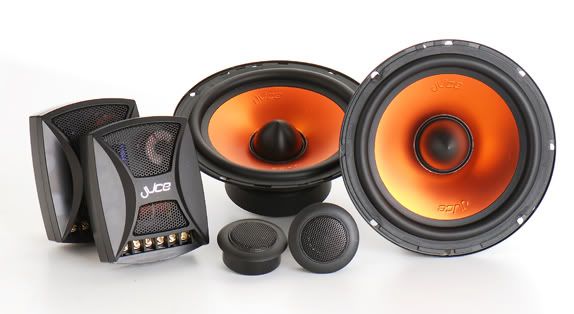

After a little noise deadening experiment i conducted HERE, I decided the sound from stereo left a little to be desired and was not a patch on the audio system fitted to SWMBO's Toyota.
So, after some research on teh internets, contrary to the popular tried and tested choice of Infinity REF6520cs components, I decided, as usual to go for the untested option - as I seem to like to make life difficult for myself at any available opportunity. :facepalm:
The speakers of choice were Juice JS6C 6.5mm components.
I have never heard of this brand, so didn't know what to expect, but they were a fair bit cheaper than Infinitys (cos I'm tight like that), and I could buy them locally.

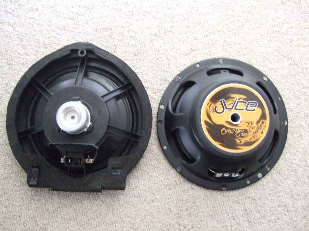

Well off came the door cards and old speakers, when I got back, and I thought It would be a simple case of swapping like for like, with the addition of installing the crossovers - wrong!
Turns out, although the clearance required for the back of the speaker was suffient (about 60mm), the actual speaker apeture in the doors was too small! Gah!!! :banghead:
Time to dust off my carpentry skills, so off I went to B&Q on the hunt for some 18mm MDF, to fashion some speaker rings. (Nothings ever straightforward with my projects!) :rolleyes:

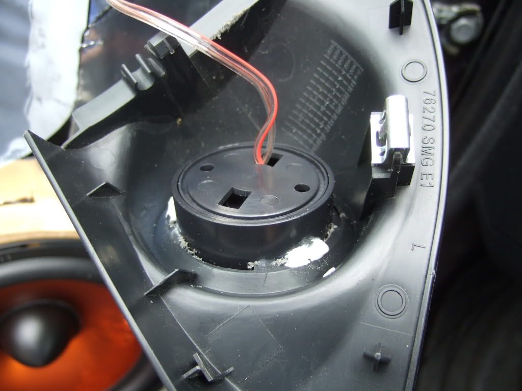

After a bit of marking out, jigsawing and filing, I screwed these to the doors. Next I set about installing the new kit and glueing the new tweeter inplace with a combination of no more nails and super glue (not mixed together, though!). After filing out the tabs in the tweeter enclosure a bit, the new units, were a perfect fit! [smilie=thatworks.g:

Driving home from work, the next day, the offside tweeter decided to cut out on me at random intervals - great. :facepalm:
So, today after the tweeter completely cut out, off the door card came, yet again and I quickly diagnosed a loose connection to the crossover. Problem solved, touch wood.

Old Woofer vs. Juice item
