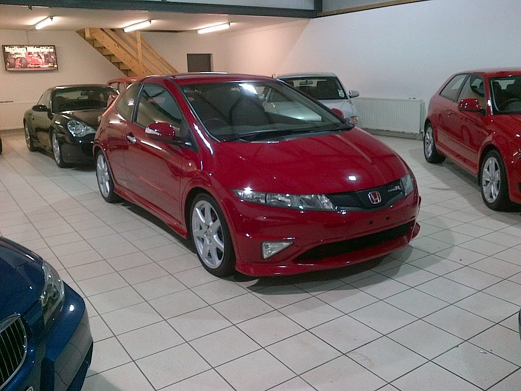

Pulled the car into dads showroom looking like this ( i had parts of the civic taped up and had starting working out what to use ..

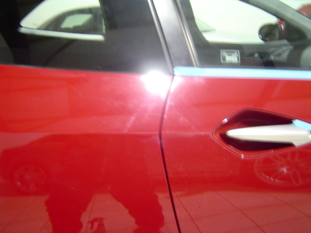

Before
Pics of the swirls and poorly washed marring etc ( Poor quality pics but should give you an idea )
Quarter panel

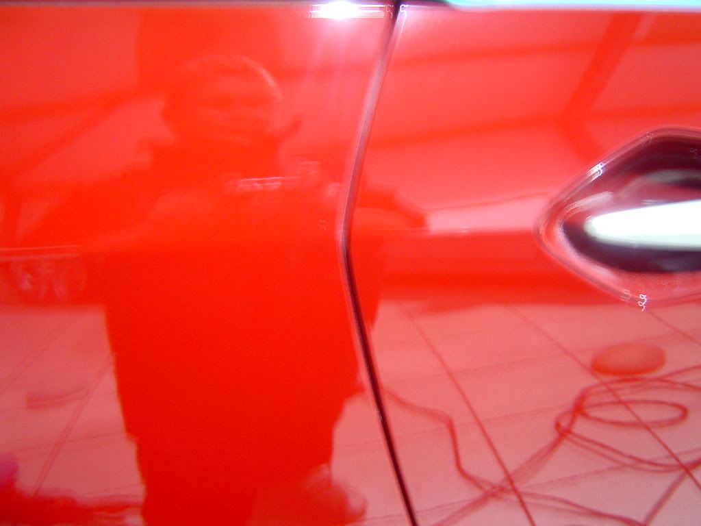

After
Again
After
After
Random swirls ( the lights are bright in this one , light has blurred , not marring or swirling)
After
