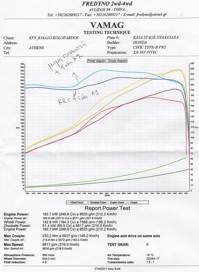

this is the dyno
249.8 best.. with the above parts
some conclusions , if i remove the toda a2 cams , but install RRC manifold , fd2 cams , and 63-70mm exaust , power will be at the same levels..
just preffered the stock exaust for noise reduction, the stock manifold than the rrc , for torque , and left the a2 cams to figure out the losses from those , up top (they managed to balance the losses)

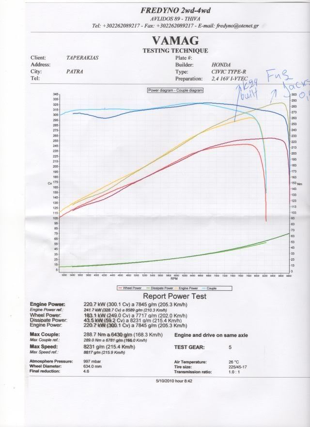

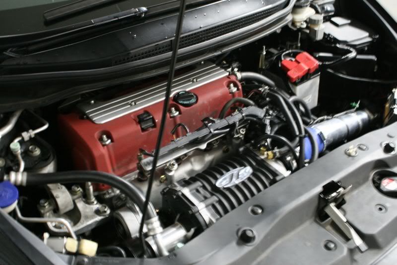

i then installed a civic si 06-09 jackson racing kit , woth3.2 pull;ey (0.6 bar at 8800) , with 750cc rc injectors , aem water meth (just water sprayed though) , kept the a2s , and 68mm t/b , along with the ep3 oil pump..
BUT left a stock cat back AGAIN :popcorn:

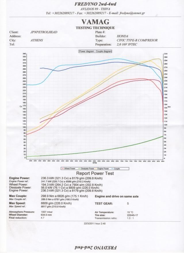

CAR made 328 at the same dyno , and was better than a k24 ep3 (88 x 99 , 12.5c.r ,bp rods, ips k2 cams , 76mm exaust , kpro , 74mm t/b ,ported rbc) , that made a very rational 300cv there
here is the plot, along with a JRSC ep3 , no a2 cams , BUT 70mm exaust

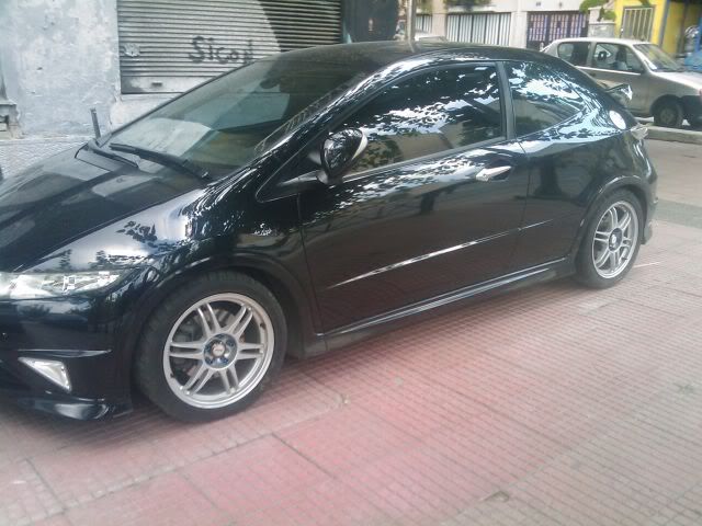

Really nice figures but those wheels? Not my cup of tea :D
Other than that great car. You said you tried the FD2 cams... have you old them already?
NOT PRETTY , but i have agood reason
17 x 7 , and 6.3 kgs weight..
thats about half the oem wheels.. u cant imagine the TOTAL gain in the cars COMFORT , accelaration , even fuel economy..
stock wheels are great looking , but honda overdid it with the weight(obviously so that they would be strong enough)
