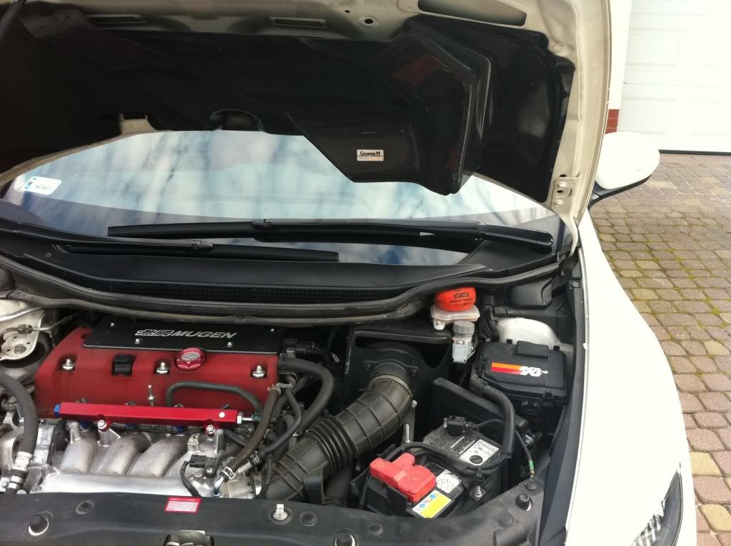

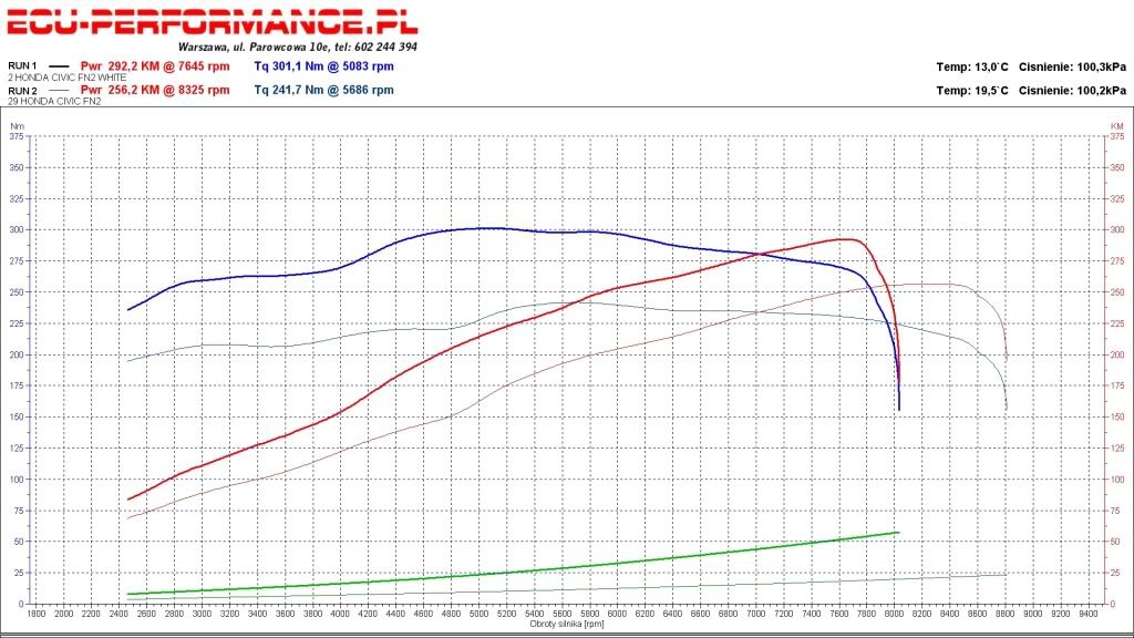

OK here it is as it's still under ECU tuning and doing maps later on the car will go to a dyno for fixes/upgrading ignition timings if needed just for getting higher numbers. Trying to get 290-300hp
Car was build by ECU-PERFORMANCE.PL, Hondata dealer in PL and very experieced in Honda K-series build, while ECU map is being done by famous VitViper from E-tune, later on it will go on a dyno, and together with ECU-PERFORMANCE.PL owner and VitViper they will choose the best set up as it was with K20 260hp. As Honda Type-R is an N/A so wanted to keep it in N/A only. Having S/C or turbo it's easy to hear, while during a sprint from traffic lights when people ask me "What the hell is inside" I'm always telling "It's K20 with exhaust 215hp" :D
We got even some guests from England with FD2 K24+Rotrex, last time I was there it was reaching 380hp got even a film from a dyno :)
Modification list :
2010, FN2 Championship White NH0, 3D
K24A3/K20Z4
Overbore to 88mm (87mm OEM) displacement go up from 2353 to 2407
Forged CP Pistons C/R 12.5:1
Forged Brian Crower UltraLight rods
Lighten and ballanced K24 crankshaft (weight reduction ~20%)
TODA A3 camshafts
TODA valve springs
TODA oil pump
Headcylider skimmed and COMETIC headcylinder gasket (overall C/R ~12.7:1) RON98 only
ARP struds & bolts
GruppeM intake
TODA Exhaust manifold
Milltek Sport Exhaust
RDX 410cc injectors
RRC Intake Manifold
M&M Honda thermal intake manifold gasket
SPOON 70mm Throttle body
CPL Fuel Rail
Hondata FlashPro
TODA Lightweight flywheel
MUGEN Copper Fiber clutch
OEM LSD

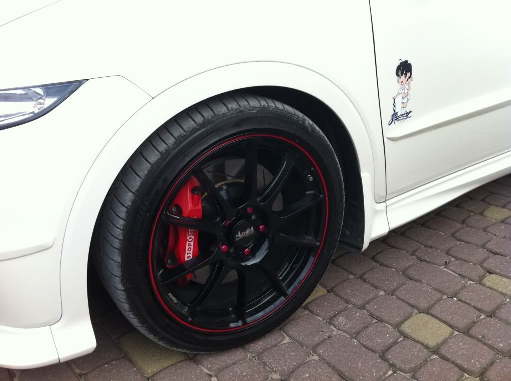

STOPTECH BBK 328x28 with ST-40 calipers
ENDLESS MX72 front pads
Project Mu BESTOP rear pads
MUGEN front grill
MUGEN rear wing
City-Pack
Tinted rear windows
GP Pack
Type-S mudflaps
MUGEN oil cap
MUGEN ignition coil cover
MUGEN 1.3bar radiator cap
MUGEN gear knob
Advanti Racing SG40 8x18ET40 wheels
Federal 595RS-R Semi-Slick 225/40R18 tires
MOTUL X-cess 5W40 oil
MOTUL RBF660 brake fluid
AWAITING FOR :
MUGEN Sport Suspension -> shoud get it very soon
Carbon J'S Racing Type-V Hood
SPOON Exhaust

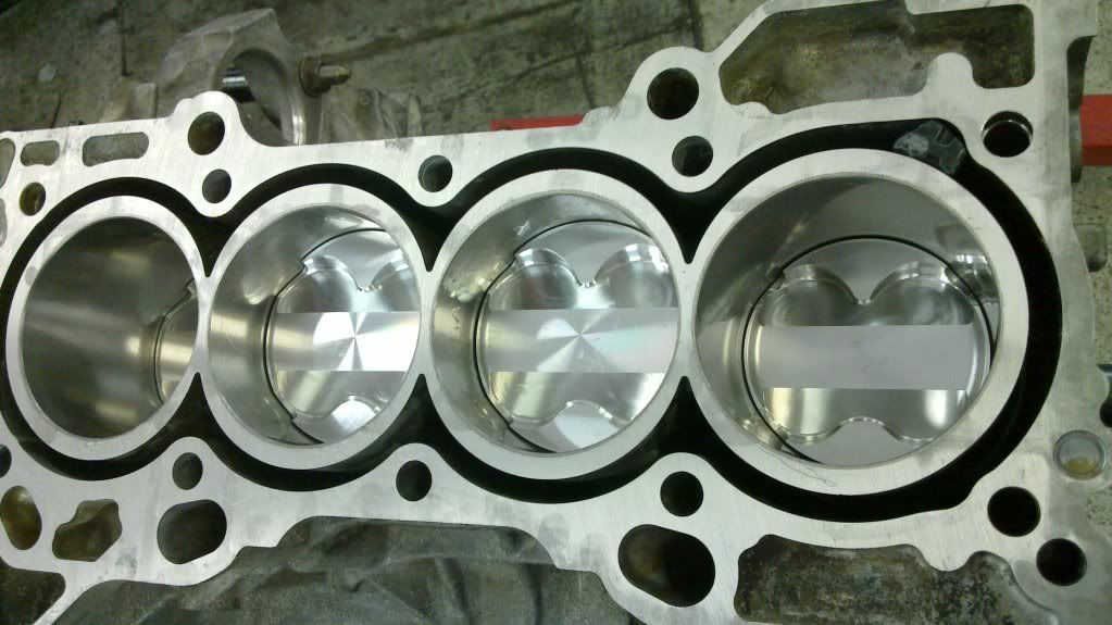

Lightweight pistons, rods, flywheel and mainly crankshaft give amazing revving. The car revvs so fast I have problems with gear changing
Photos :
K24 with new pistons ready

whats your rev limit
Currently it's set up to 8000rpms. It's quite safe, later on we will check out if the car produces more power till 8500rpms (which is ~9300rpms equivalent in K20). If it's not - there is no sense to rev it such high and we will lower the revlimiter.
