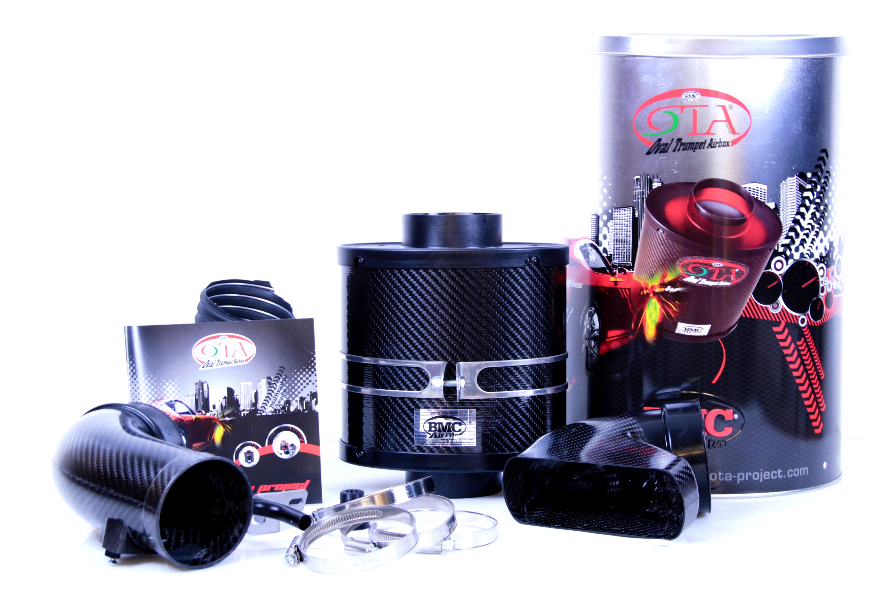

Theres K&N apollo systems...among others...
There is also BMC CDA.
Cant give any rating, but they are true enclosed cold air intakes.
BMC ACOTASP-24 is available on amazon

That's great. Thanks! I will def. take a look at that universal CAI K&N Apollo... Or even go for the (very expensive) BMC!

Unless you can do something about the MAF sensor in the airbox with a MAF tube/adaptor + silicon that wont need ECU recalibration, the BMC might be the sensible option.

Doesnt lool like the apollo, being a universal kit, comes with a MAF sensor housing.
You can of course get a MAF housing of the required size from many places.
But the MAF sensor is tuned for a specific housing length, path, inner diameter.
The universal kits are left for you to route and make work.
Thats fine if you can get a remap to get the MAF sensor recalibrated (which it may not need if you're lucky).
But a bad MAF reading would mean running rich or lean when out of closed loop.
I think K&N might do the 57i among others that might be a car specific kit.
Some of their other enclosed kits are £500+, so they wanna be.
But they dont make finding the model specific details easy for these.
Look on their website for the other enclosed kits they do now.

I like parts that are bolt on plug'n'play :D So I might stick with the BMC ACOTASP-24. They look and sound pretty good on the videos. But I can't seem to find out if these are compatible with the car's MAF sensor? I don't want to screw something up without sensors or having trouble with check engine lights...
