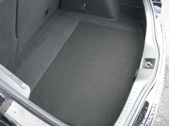

So i've been very excited cruisin a couple of days with my new ice install ;-)
Now u see it!
Now u dont! heheh...talk about stealth!

What im impressed with the most apart from the startling improvement over the factory audio, is the great boot build these guys did and the time they took to "tune" it after to ensure the result was what i was looking for. Its all discrete, neat and tidily tucked away in a very nice boot build so i can use the entire boot for storage as needed!

no's - 2307,2308,2309,2310 - In the boot we decided to build a false floor to house everything and also hide all the wiring. The sub box and battery were sunk into the floor and everything was covered in black carpet.
