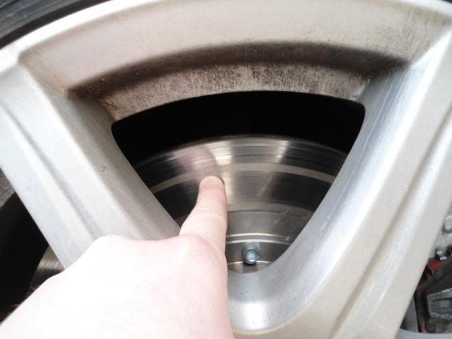

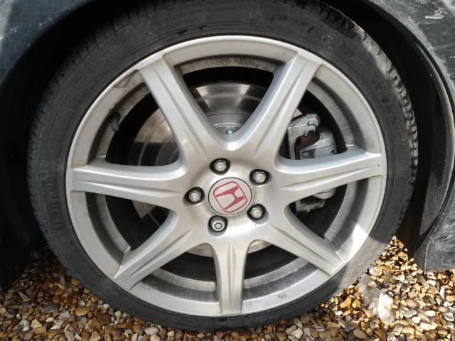

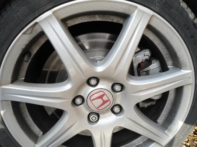

I've recently had my Powerslot discs fitted (thanks to Noxia for selling them to me ;) ) however, I'm a little concerned after my 150 mile round trip today that there is a thin raised groove in them (exactly the same both sides), piccys below. Is this normal? I've been very gently bedding them in (no hard stops, no pumping the pedal at high speeds etc...), they are no where near bed in yet as they don't feel at their best.
Anybody else have Powerslots that look like this? I'm a little concerned :facepalm:
Please excuse the dirt it's not worth cleaning it lately :rolleyes:

I have just been advised that because I've used my existing pads (EBC Redstuff) they would be set to my old discs.
I've decided that I have had enough of the Redstuff pads and am giving the Ferodo Premier pads a bash. (Didn't fancy shelling out for the DS2500 for now)

My own fault really. Didn't really want to change the pads because there was plenty left on them. But they are causing uneven wear to my discs and I've had enough of poor braking when pads are cold :(
I'm just hoping that these Ferodo Premier pads are going to be okay. I don't want to be going back to how it was when I bought it (poor brakes).

Don't worry that is a high spot of the pad, They will wear in eventually and the mark will get bigger until it evens out, I had this with my greenstuff pads on my warped discs. When I changed the discs the green stuff pads evened out over time.
Just take your time thats all.;)

As others have said old pads on new discs have caused that.
