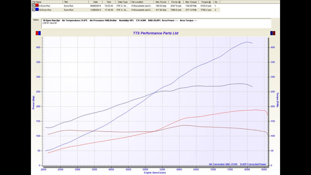

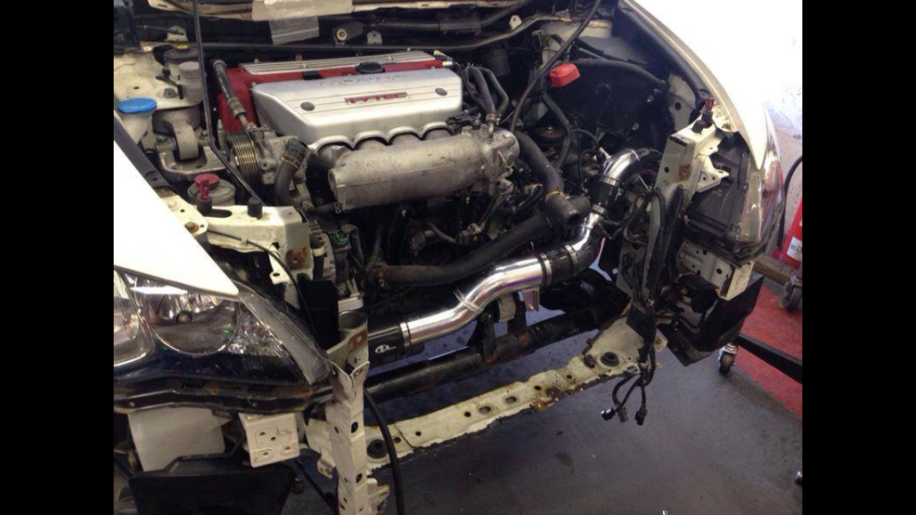

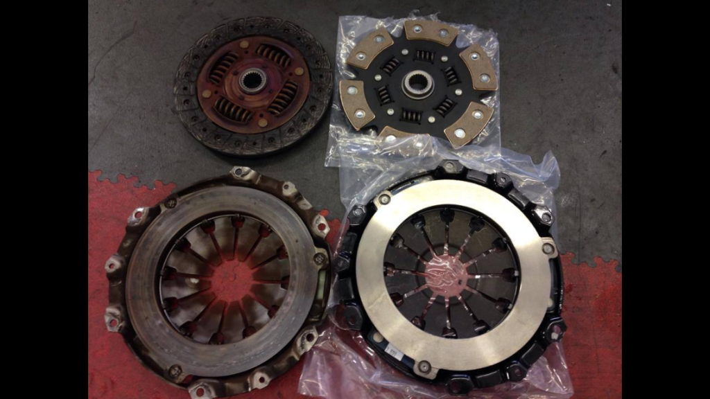

Thought id share with you my results from my tts rotrex race kit. Got offered 15% off and as i was saving for one anyway i jumped at the chance.
Well happy with the results 418 bhp at the wheels apparently the acceleration is savage, 1st and 2nd just spins the ad08r's up but once you get into third its controllable. Its running 14 psi of boost on a stock engine with a stage 4 comp clutch. http://
The red is the power run before the charger just running flashpro and gruppe m mapped by cpl it was making 236 bhp at the fly

Wow great results mate, awsome power at less than 1 bar boost. Hope you have some dry weather to use and abuse it :top:

Nicely done, got similar power here, 417.xx at the wheels on TTS rollers, only at 9psi though on a kraftwerks c30-94. Hellish fast and brings a smile to my face all the time, I can only imagine your grin being just the same :)
