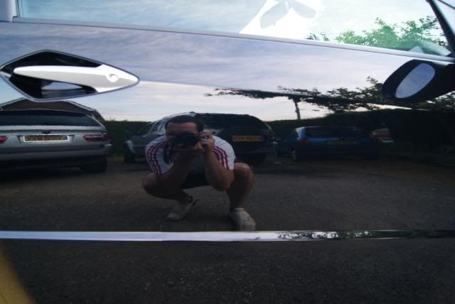

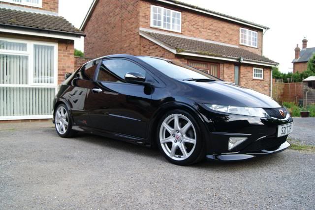

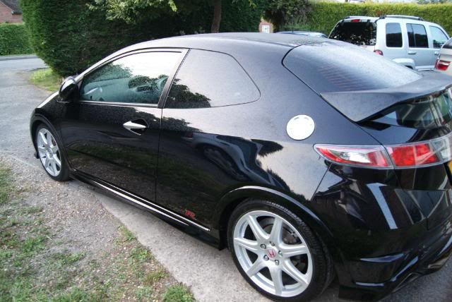

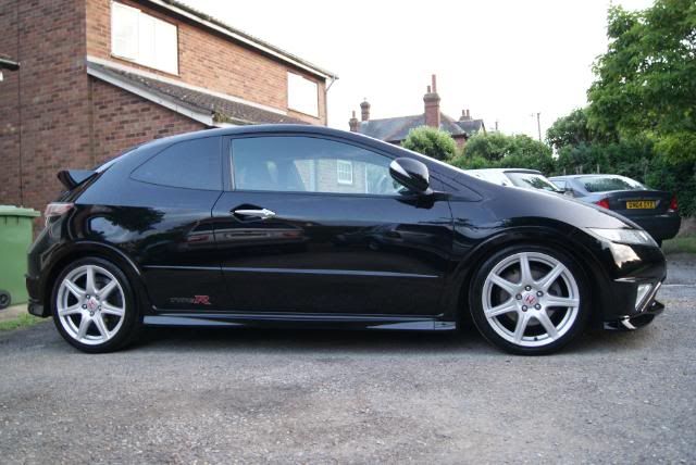

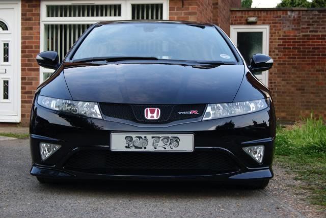

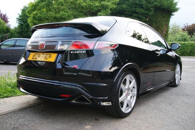

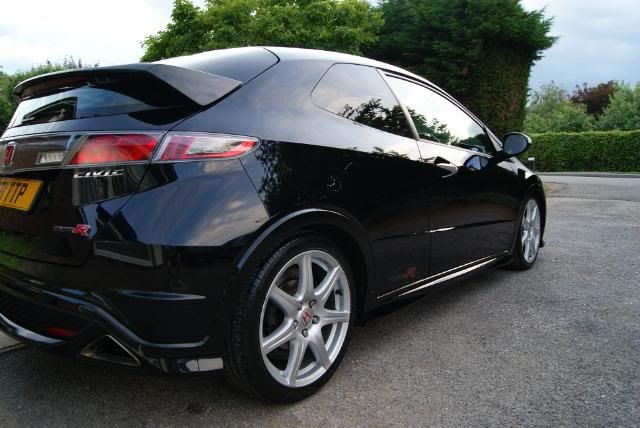

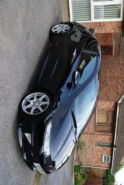

Well I spent today (10:00 - 19:30) detailing the Civic as it was in dyer need of one since I bought it back in January.
Anyway the process went like this:
- Wheels cleaned using Wolf's Chemical Wheel Cleaner (cracking stuff this)
- Front bumper and arches sprayed with Megs APC, agitated then rinsed.
- 2 bucket wash using Chemical Guys (CG) Citrus Wash & Gloss
- Dried with waffle towel
- Whole car clayed using soft/medium clay and CG clay lube
- 2 bucket wash and then dried again
- Minor correction and polishing using a combination of compound pad and CG Swirl Remover Polish and polishing pad and CG Pro Polish
- Poorboys Black hole glaze applied
- Dodo Juice Blue Velvet wax/sealant (applied and left to cure for 30 mins then buffed off) 2 coats
- Alloys sealed using RimWax
- Tyres dressed using CG New Look Trim Gel
- Windows cleaned
- Plastics dressed with AG Bumper Care
And finally I put my new 'Type R' decals on when all was finished (used some spirits to remove layer of wax before applying decals then reapplied wax afterwards ;))
All in all I'm impressed with the finish, the paint is very soft and the bonnet looks a state now that I've cleaned it up (stone chips everywhere). This is also the first time that I've tried the Dodo Juice stuff so I'll have to see how long it last and how well it does :p

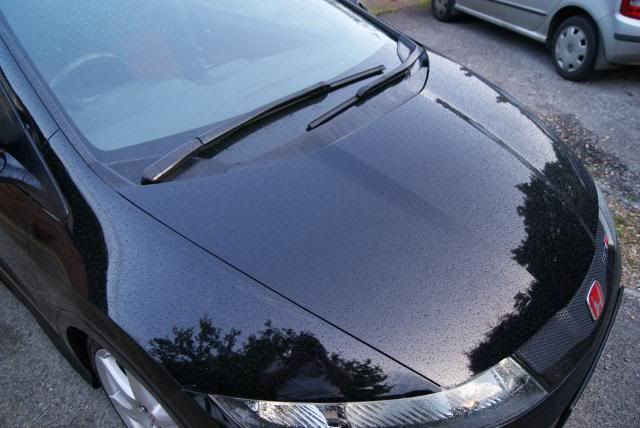

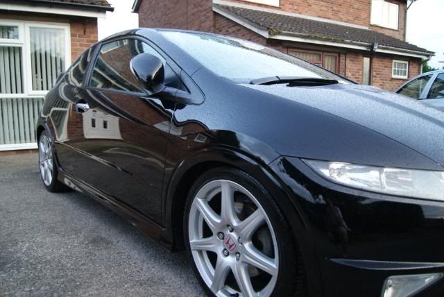

It started raining a few minutes ago so I nipped outside for some beading shots :popcorn2:

Good work and nice beading shots.
Dodo waxes don't stay long but they give supreme shine. They better working when next coat is next day so if you have time try one more apply but its great
