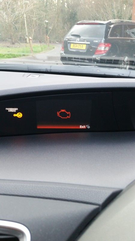

At about 3 months I was left this present by my neighbour
And today we have this lovely little symbol
The AA diagnosed this to the DPF, which I was sort of expecting at some point, just not 6 months and 4,500 miles into ownership. Left with Honda dealer who have a 2 week waiting time:popcorn:

You were right, not a DPF issue as such, faulty fault code (P2002). The DPF was 2% full (not sure how they can tell?), so reset the car and whilst doing that also managed to get the auto wipers to work which have never worked:D
Lets hope that's it:cool:
