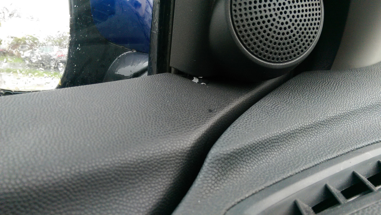

This has been happened for the past month and not sure where the water is coming from. When its been raining water is forming underneath my passenger side tweeter and when driving the water dribbles down towards the speaker. I've pulled the tweeter off and the water seems to be pooling inside but still not sure how the water is getting into this area.
Any ideas?

First obvious thought is that there is a leak from the door mirror seal. Remove the speaker and then get the garden hose on the outside of the mirror.

So I think I know where the water is from now. Was able to see the water dripping in with the tweeter off when I was driving through the heavy rain.
It appears water is going through this hole which can be seen when I pull the door rubber off. Is water meant to be getting underneath this rubber? I might have to seal the hole with some bathroom sealer.
