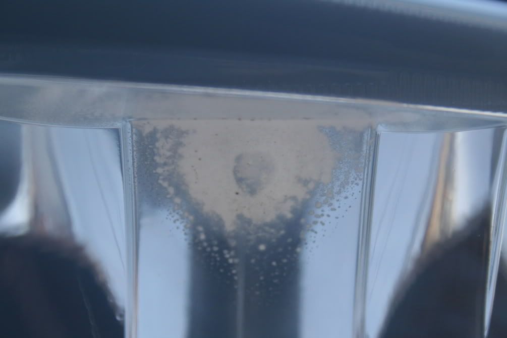

6: here is a picture of the xenon headlight unit from the FK/FN civic to show the glare shield.
5: yes i do, and playing with bulbs, tested h7r hid good ones, its light output are glare, tested lots of led's , its worst then proper hologen, now using philips white vision hologens, friend has civic with oem HID, there is no compere vs aftermarket HID's in glare and cut off, and light distribution. I looked close to oem hid, its completely different housing of bulb, it has special lower shield, different shape of reflector etc.....
