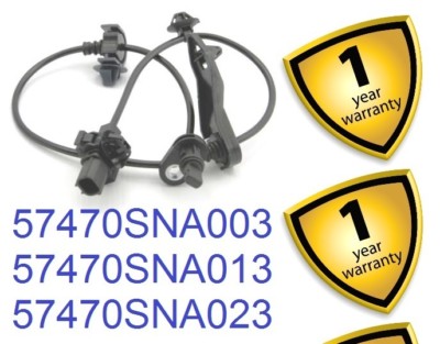

#43 ·
Well my abs/vsa light just came on again when i nipped out
Plugged the foxwell in, rear right sensor again
Seeing as this is intermittent, do i need a new sensor or could it be wiring / bad plug connection etc
Yesterday that sensor was registering wheel speed why driving perfectly on live data on the scanner.
I thought if the abs sensor stops working then it stops working
Ive already cleaned it a while back an the metal toothed cog it reads from.
Will take disc off have another look
I should be bleeding all 4 wheels again this week sometime when i get some more fluid haha
#45 ·
id buy a sensor from ebay like i did about 13 quid and i ran car for about five years and and as far as i know 18months after switching to 9g a old friend is running round in my old 2.2 still going strong
when the abs sensor went on mine i had about a month when light popped on and off till staying on thats when i bought the foxwell code reader bought code reader and sensor for less than a sensor off honda never mind labour charge for reading code
#46 ·
The vid sounds like ABS pump kicking in.
Just a fyi, my OSR abs went recently and I had the exact same thing, pump kicking in under relatively light brake applications.
Only I had a abs fault light on.
Replaced sensor for one off eBay and all fine. I don't know why the pump kicks in when theirs a fault you would think abs would be off but it must be partially on or the car thinks it's skidding unevenly causing the brake force distribution to try and correct it (if these cars have it).
Either way would look to replace the offending sensor. Eventually it will stay on permanently anyway
#47 ·
simple to replace even if you have to drill the old 1 out
if you need to drill it out just remove disc and you can gently drill though a hole on the hub
