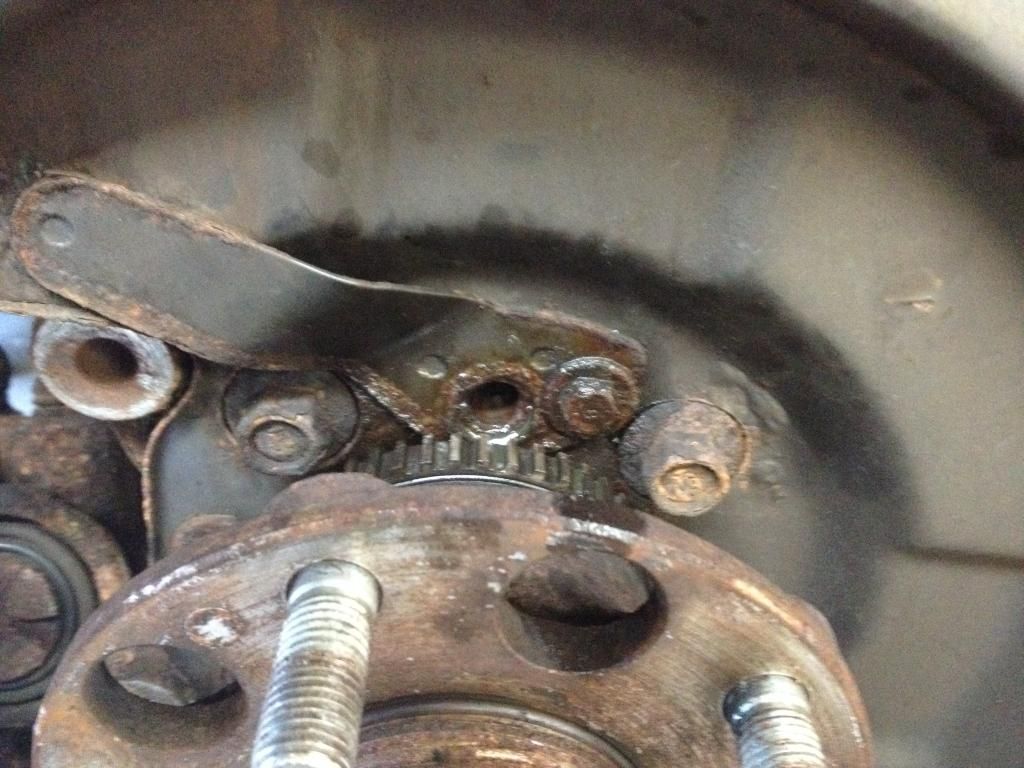

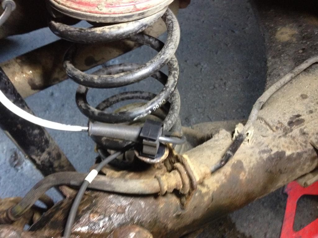

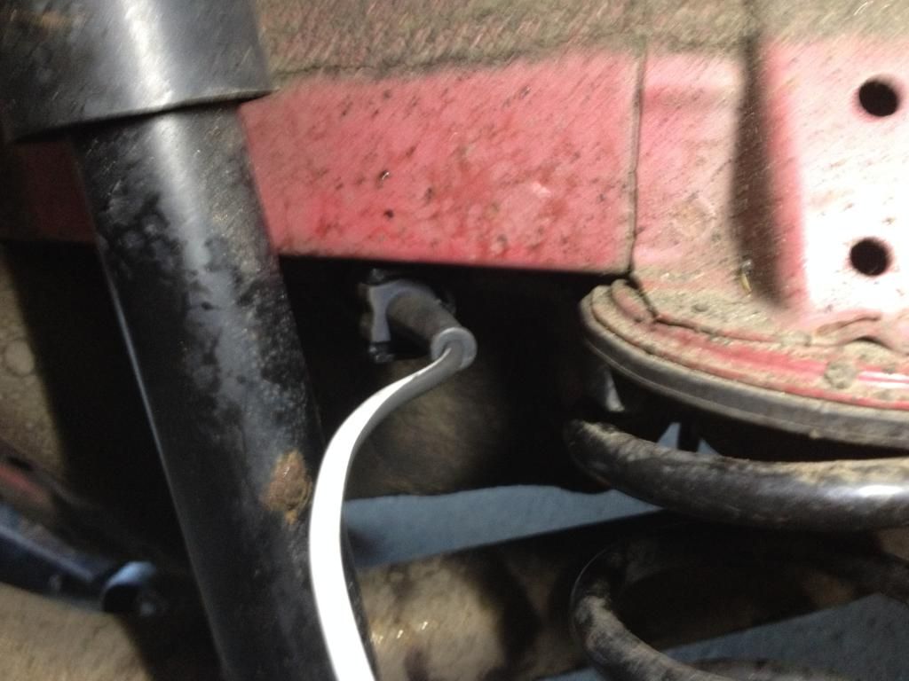

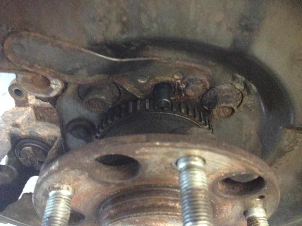

I took some pics when I replaced my near side rear sensor at the weekend.

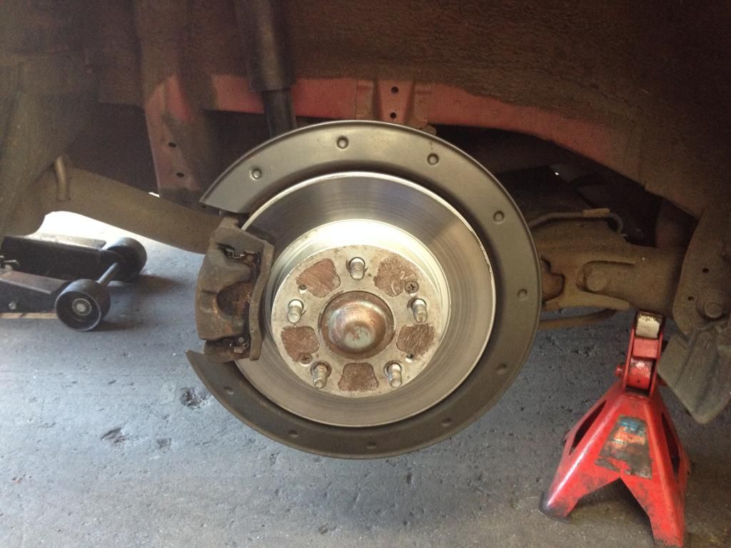

It's pretty easy, remove the caliper from the sliders using a couple of spanners (13mm and 15 I think), and pull it away from the pads - support it on an axle stand. Remove the caliper carrier complete with pads by removing the 14mm bolts.

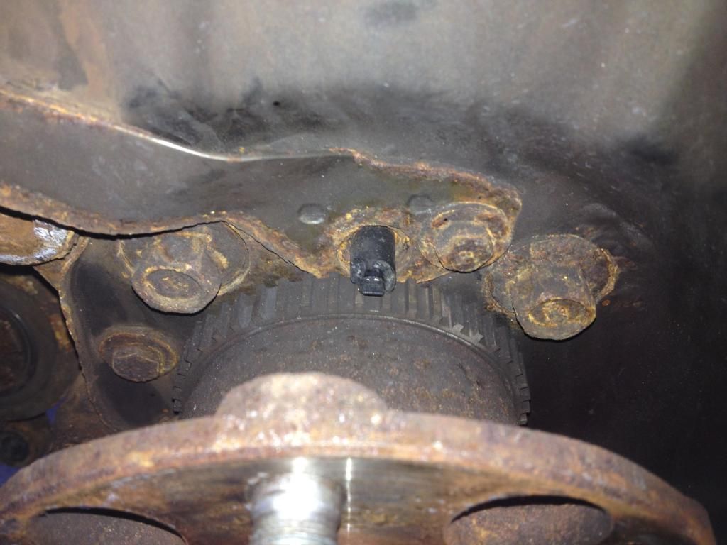

Remove the disc and you'll see the offending item poking out at you. There is a 10mm bolt holding it in place on the rear face of the hub. I recommend soaking it in plusgas or similar, and removing the rust from around it. try wiggling it out, if it won't budge you can drill and/or punch it out through one of the holes Honda kindly provided :)
Clean out the hole and the rear face before fitting the new sensor, it needs to sit fully in position to read correctly.
Spin it a few times with the ignition on before fitting it all back together - your warning light should go out :)
Your instructions are a great help. Sadly I saw them after my efforts! I tried desperately to get it out from behind (fnar fnar) without removing the caliper and disc. The 10mm bolt came off with a 3/8" socket (because the full 10mm of material was not intact ;)) but the plastic part snapped when I tried to pull it out. Then I tried many many methods to get the rest of the sensor out of the hole. This involved almost completely destroying the old sensor. Don't bother trying! Just take the disc off!!
It took me about 4 hours in total (in the rain) because of my foolish antics. Once the brakes were off it was easy. I punched it through from the brakes side with a big-ass screwdriver and then had to ream the hole out a little (carefully trying not to drill the teeth off the big cog). Greased up my ÂŁ13 eBay replacement and slid 'er in, powered up the car and immediate results - no "BING!" and no warning lights! Woohoo!
Next time it'll take 45 minutes and I'll probably do the brakes at the same time.

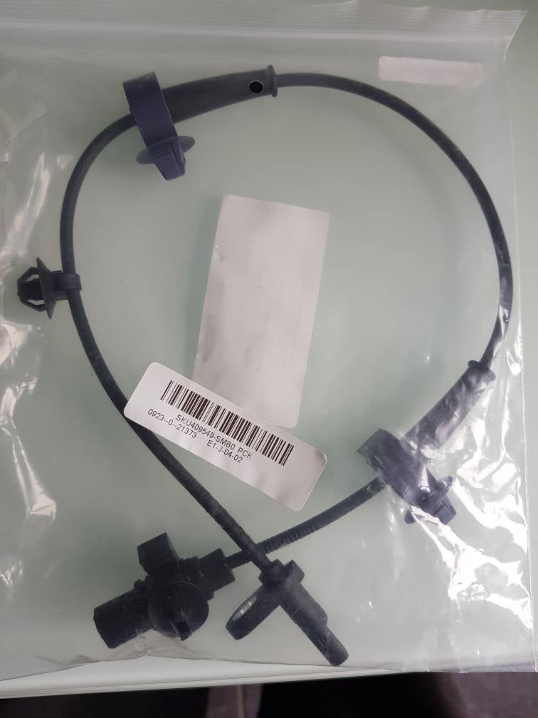

This is part number I order from ebay
