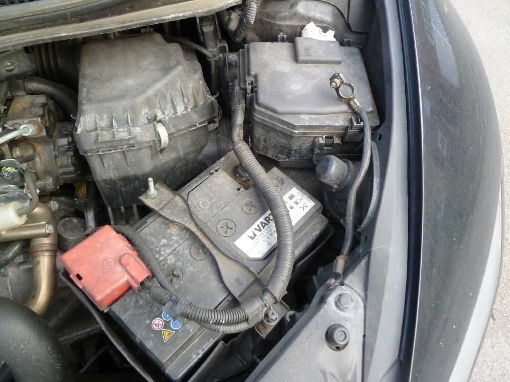

I had to change the battery in the civic the other day as starting was getting a little laborious in this cold weather and thought I'd share some pictures.

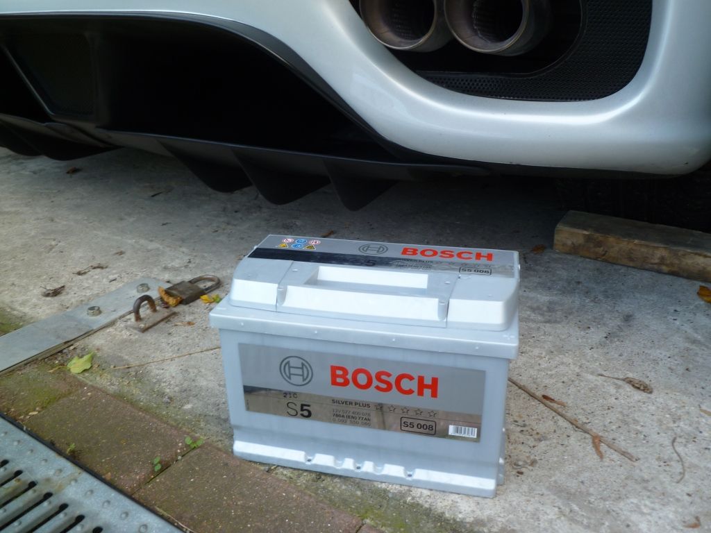

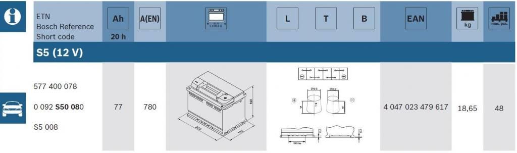

The correct battery is an "096". Here are the specs for the Bosch S5 battery that I bought:

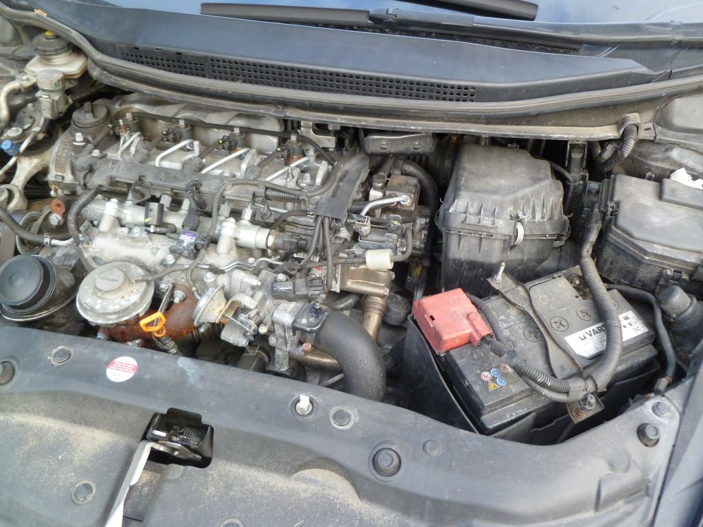

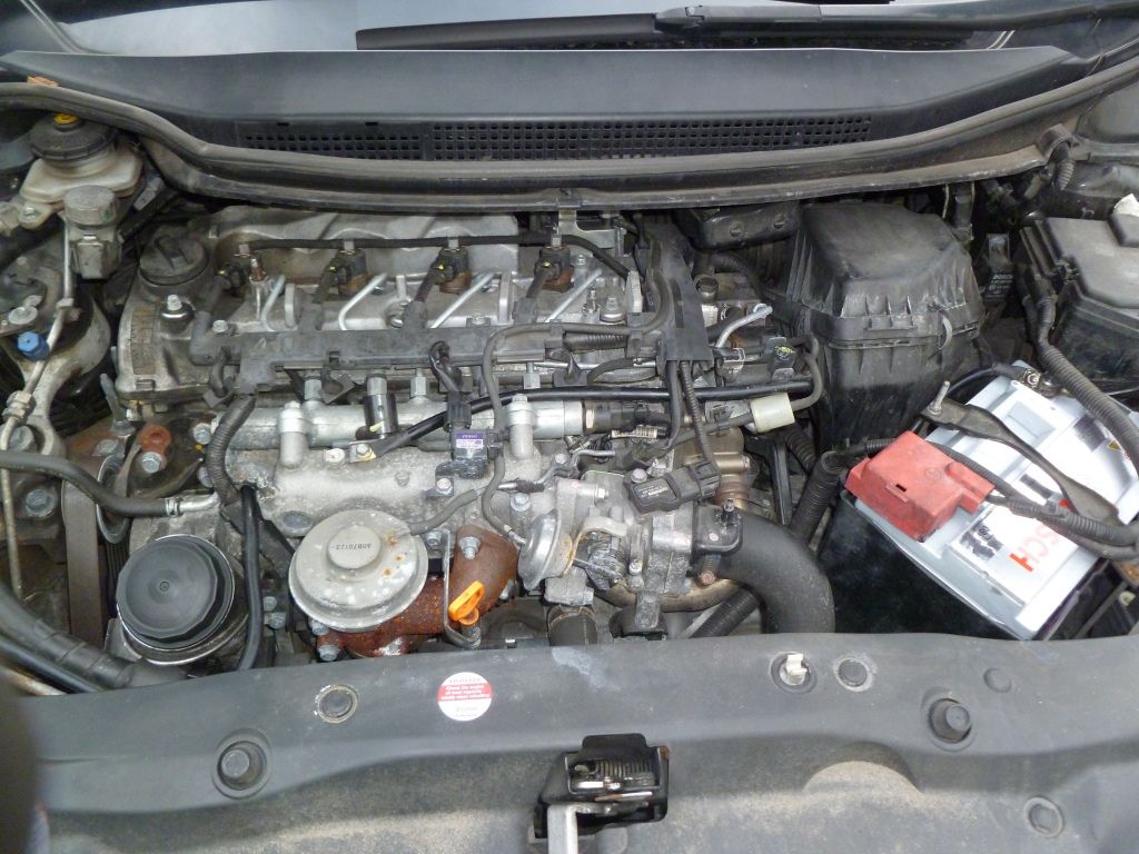

First of all I removed the engine cover - it is held in place with four 10mm nuts and reveals this:

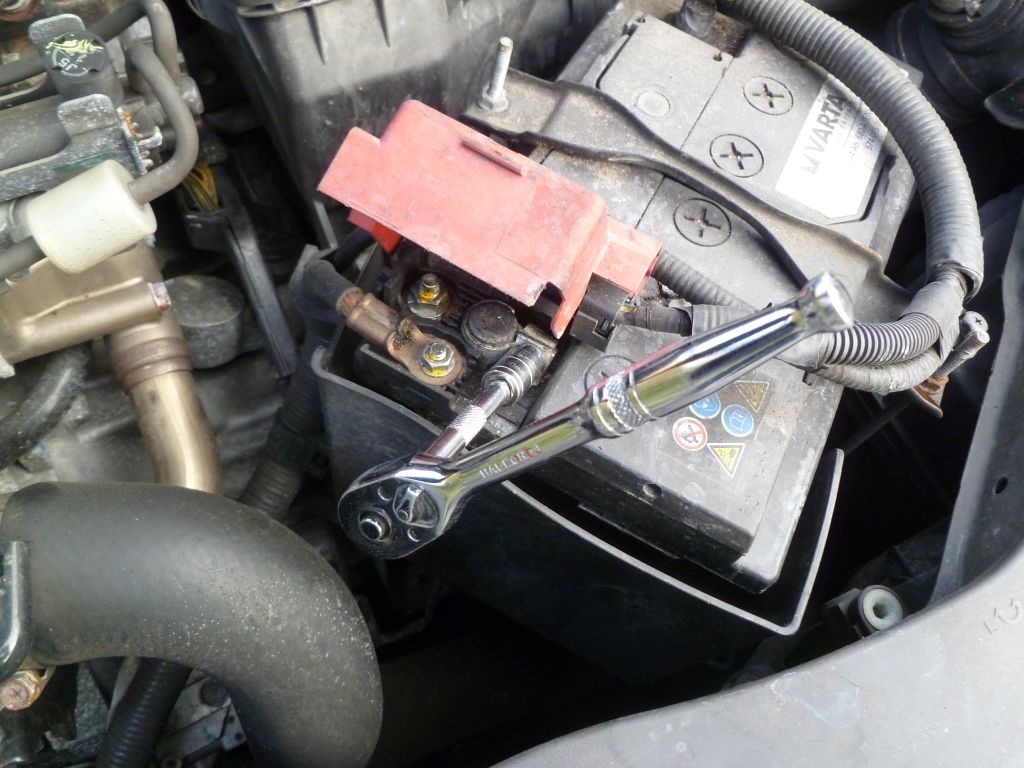

Next remove disconnect the earth strap - it is vital you do this before touching the positive connection as it prevents any shorting out onto the body. The clamp is held in place with a 10mm bolt.
Now you can go ahead and remove the positive lead - again a 10mm clamp hols it in place. You will also need to undo the cable tidy that fits onto the battery strap (it can be undone with a 10mm socket).

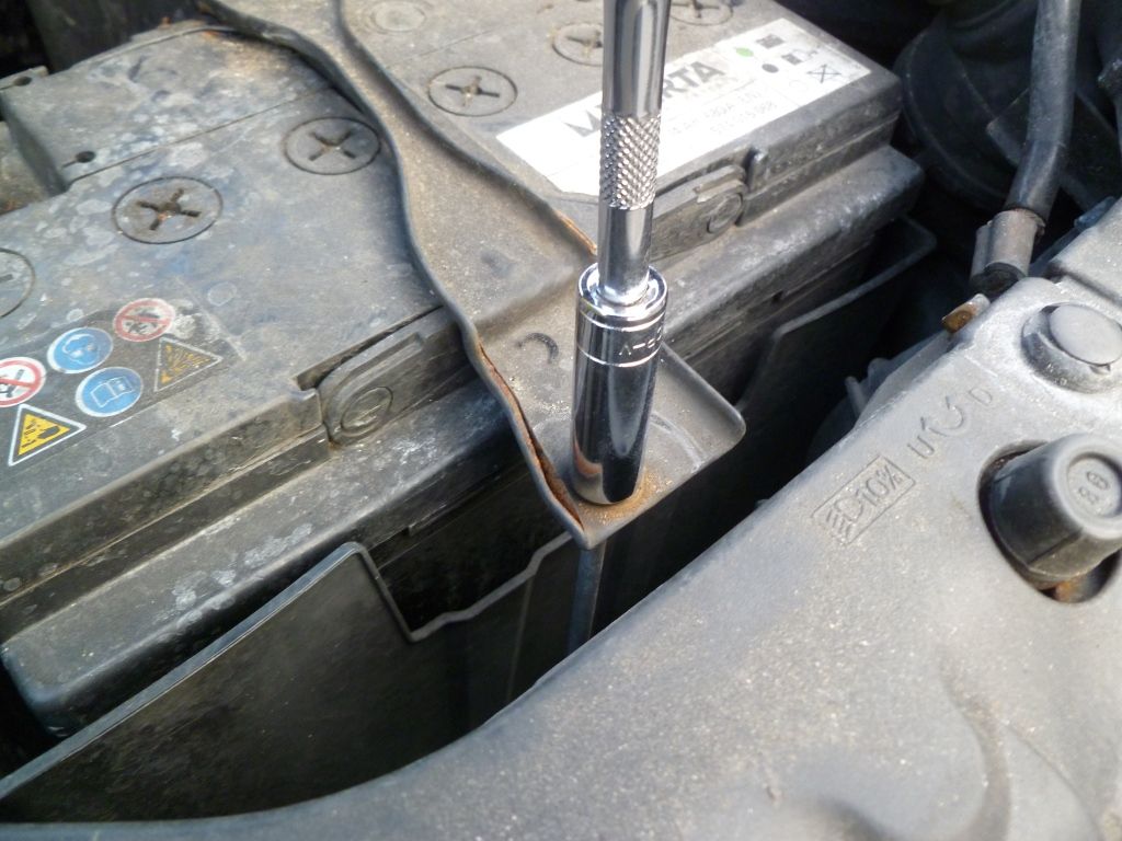

Now you can loosen the battery strap. You'll need a deep 10mm socket or a spanner. You don't need to undo the nuts all the way - after they have been loosened the other end of the strap will unhook. The battery will now withdraw from the car.

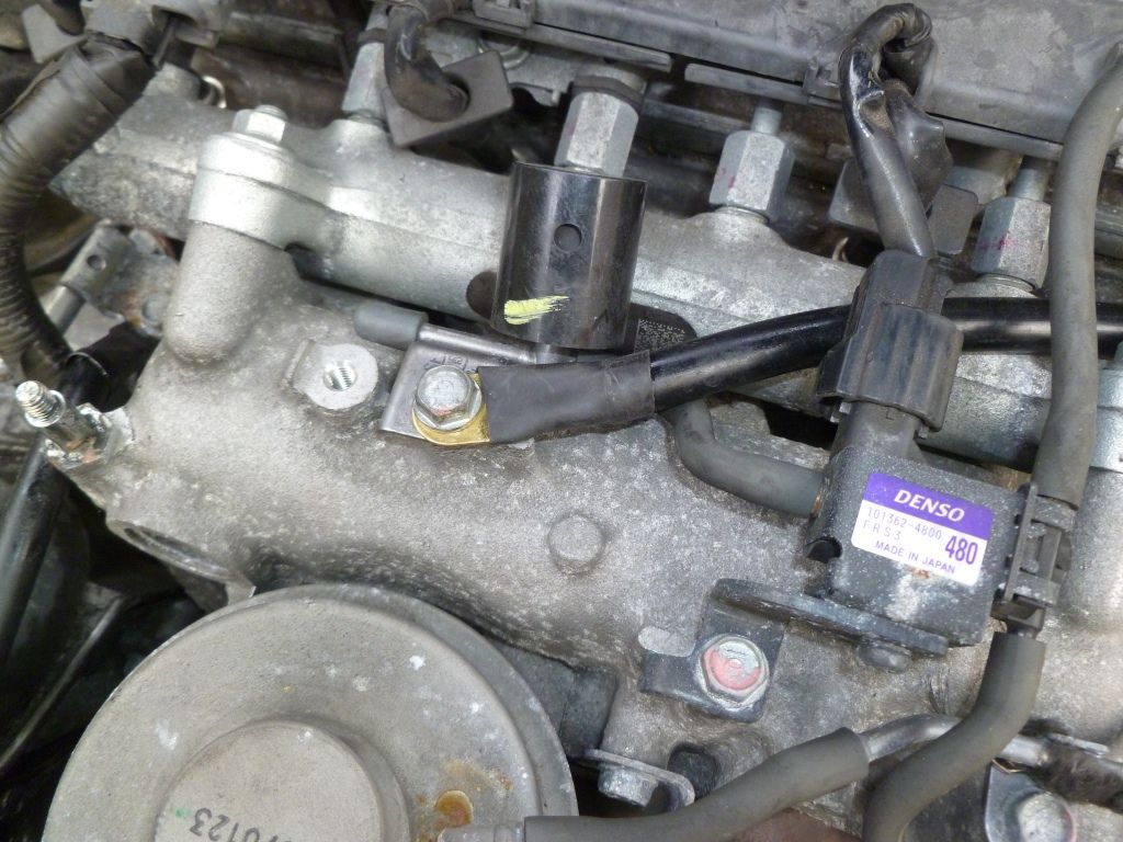

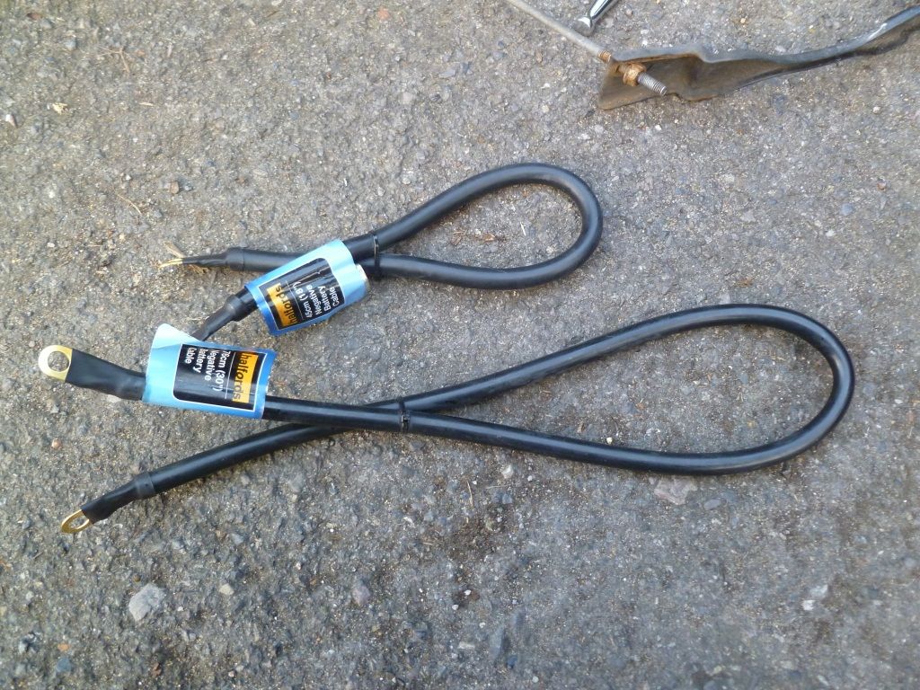

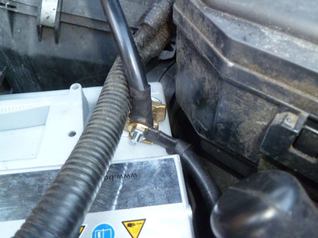

To improve the earthing, I bought 30" and 18" earth cables from Halfords - cost was about ÂŁ8 with a trade card. As it turned out, a 24" cable is probably a better length to buy than 30".

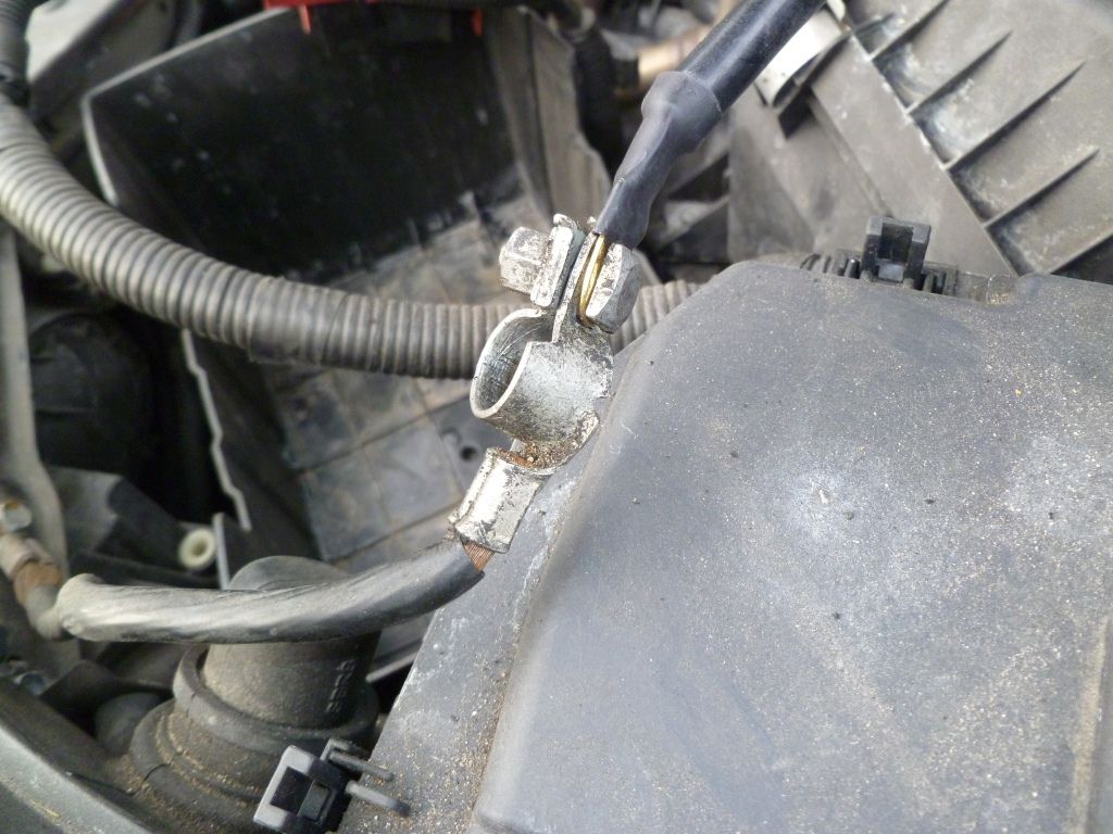

One end of the long cable goes on the earth clamp like so:

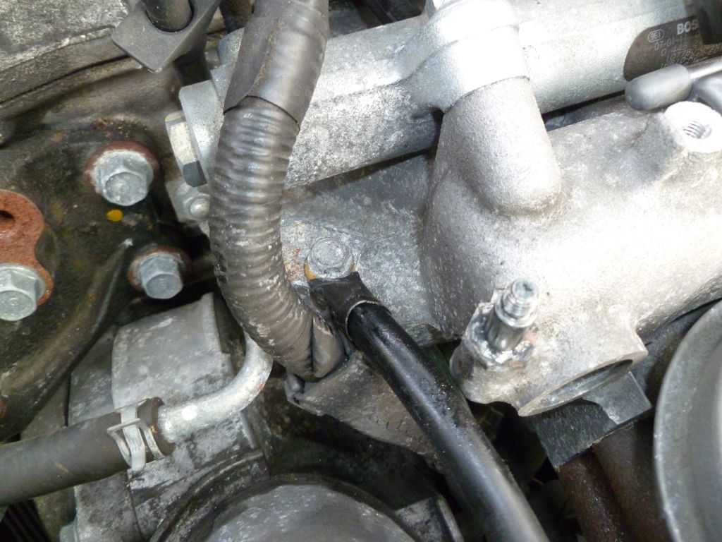

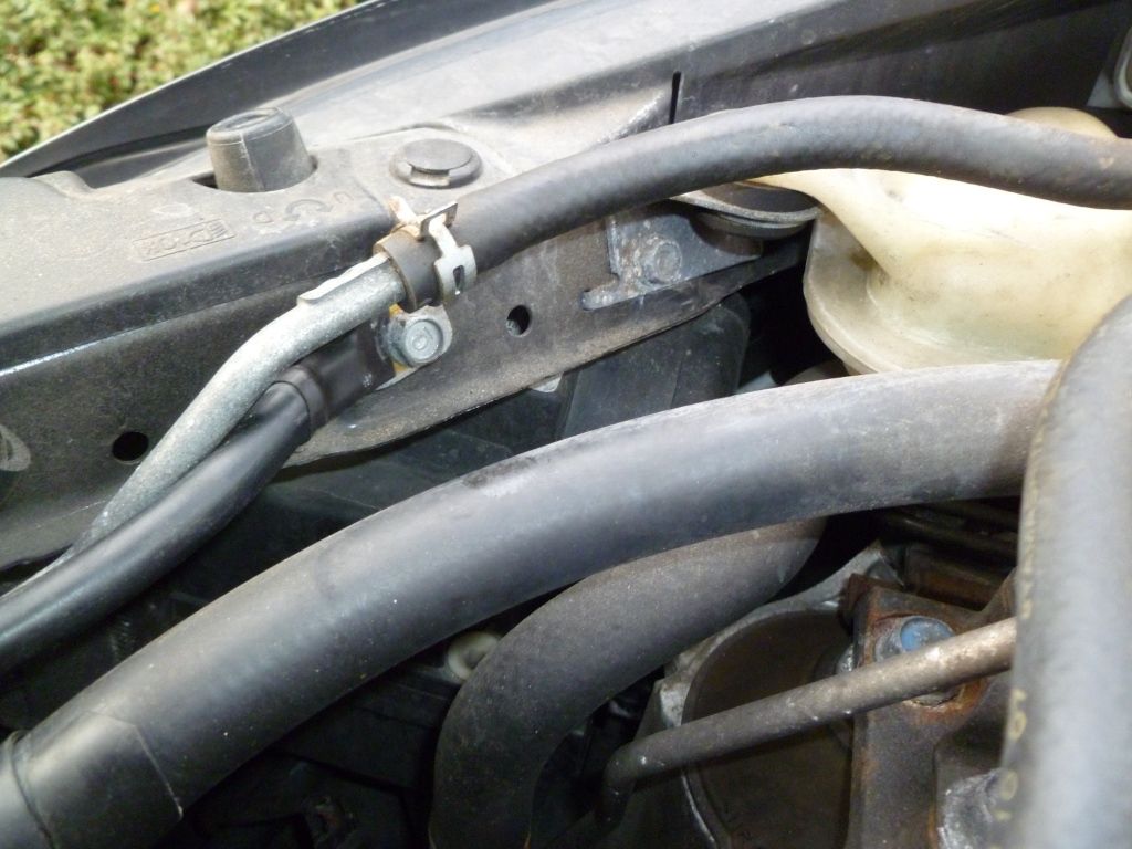

The other end is connected to the engine as shown:

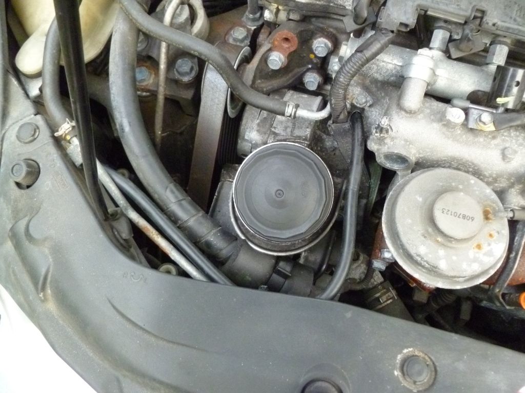

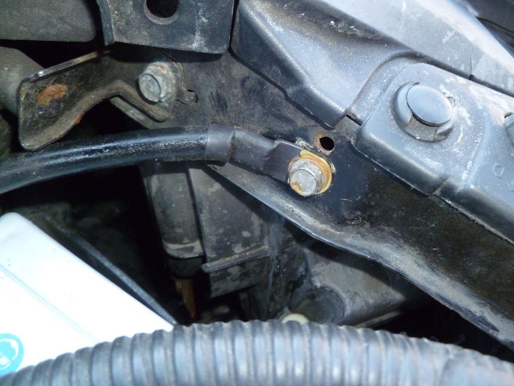

The shorter of the cables goes here:
and here:

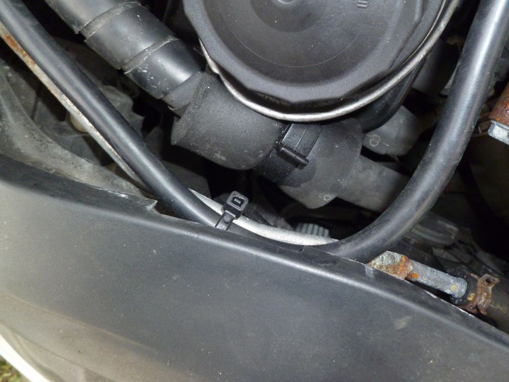

Zip tie it in place:

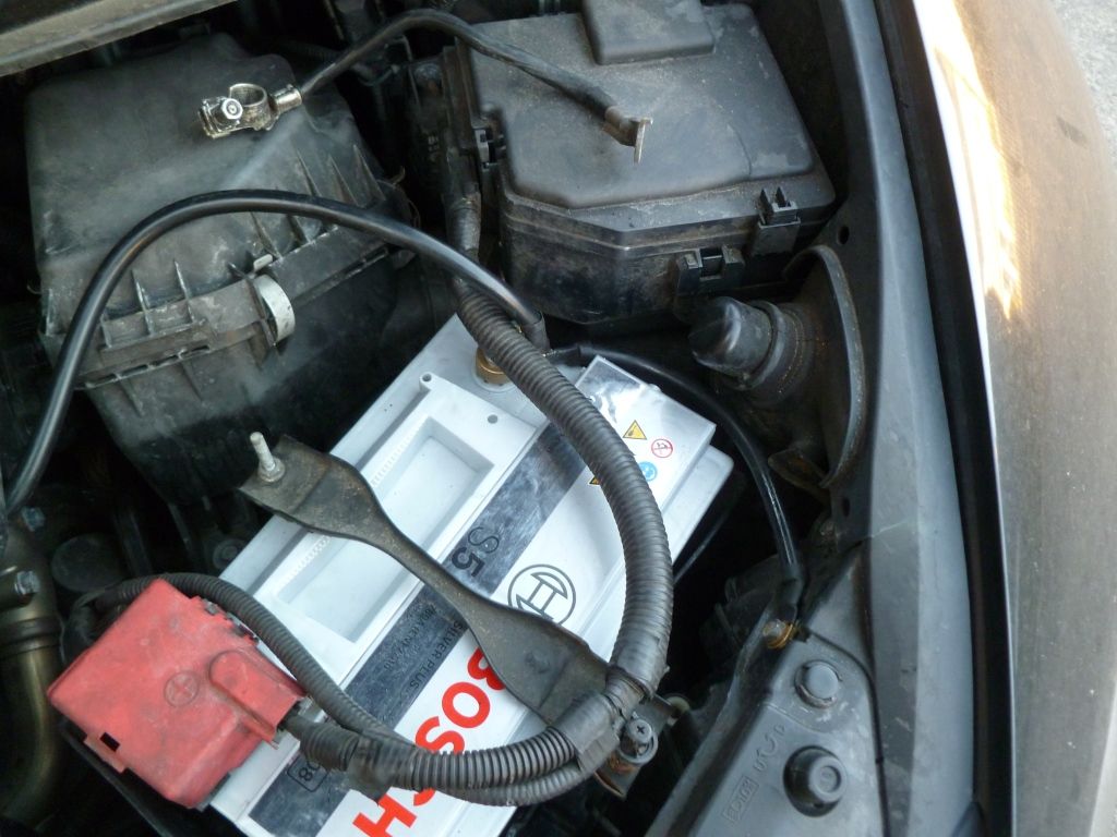

Here's the route of the longer cable:

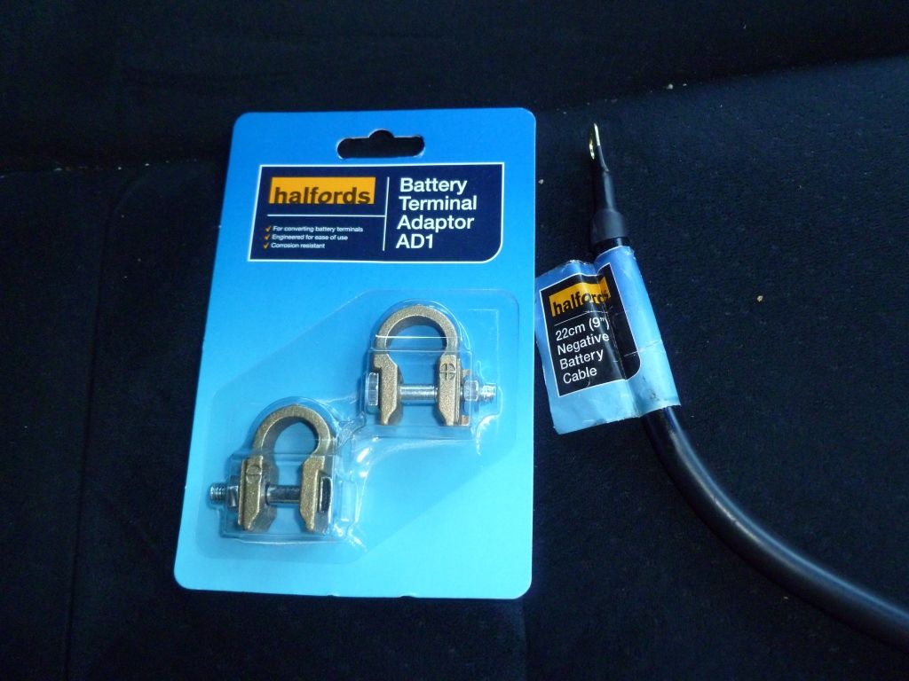

After I had fitted the new battery in place I wasn't happy with the tightness of the earth clamp so it was back to Halfords to get a new clamp and strap:

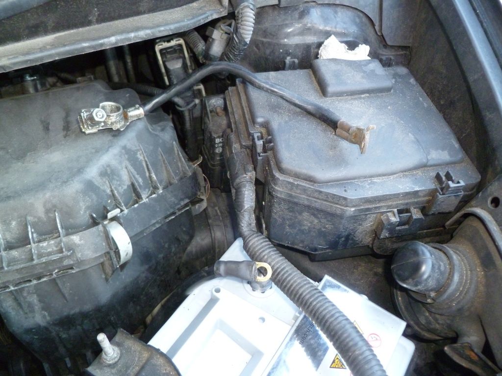

I removed the original clamp and cable:
And fitted the new clamp and cable:
Here it is all in place:

could be a cheaper alternative to parscos grounding kit .
any noticable differences
wold it be ok for the 1.8 petrol also
#3 ·
It's hard to tell if there's been any improvement as starting the engine was very laborious to begin with and the new battery has helped a lot.
Parsco's kit is much better quality than the Halfords cables I put on but I fitted what was available at the time. I would recommend changing the negative clamp at the battery as the OEM one is woeful - the Halfords clamp and 9" cable came to another ÂŁ7 with a trade card.
I've got no idea if it would be suitable for a 1.8 petrol but I don't see why it wouldn't. All the wires are doing is adding extra connections between the battery, chassis and engine.

I'm sorry I don't know anything about the 1.8 engine - you'd have to measure up yourself.
The cables are sold in 9", 18", 24" & 30". For the 2.2 diesel I recommend using the following lengths:
24" (Battery to Engine)
18" (Engine to Chassis)
9" (Battery to Chassis)
I also recommend getting a new negative terminal clamp.
