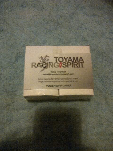

I got replacement bulbs from Toyama Racing Spirit(thanks Sean)
New vs Old
